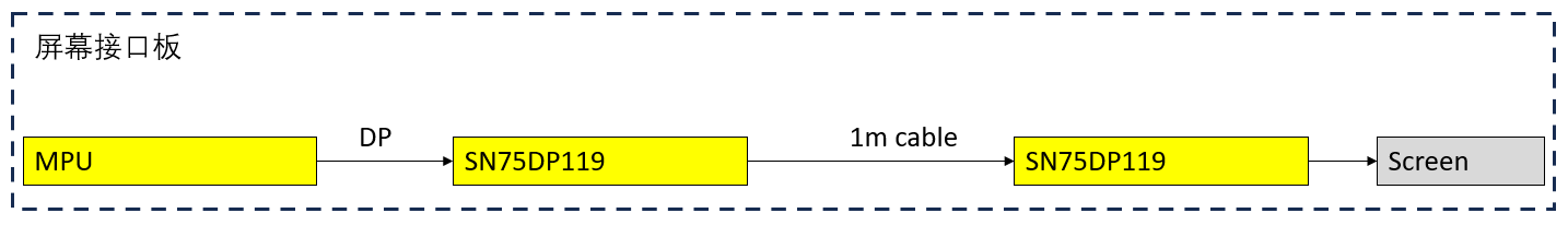

Can SN75DP119 support cascading.
During testing, the customer found that even when the MPU is not outputting a DP signal, they can still detect signals on the output side of the SN75DP119. Furthermore, the output signal amplitude is smaller at the SN75DP119 closer to the MPU end, and larger closer to the Screen end. Therefore, we would like to confirm whether cascading could be the cause of this issue.

    The customer tested a few test cases and found the SN75DP119 output as shown in the figure below:
    The EN pin of the SN75DP119 is directly connected to VCC, so the SN75DP119 starts working as soon as VCC powers up.
    We used a differential probe to test the output of the first SN75DP119. We noticed that whether we disconnect the input of the SN75DP119 (or tie it to GND) or disconnect the output, we can still detect an output signal at the SN75DP119 output. Therefore, we believe this signal originates from within the chip itself.
    yellow is HPD , pink is DP119 output.
    We understand that the DP119 is a wideband amplifier. Could it be that some noise is being amplified? The output we observe from the DP119 is unorganized noise rather than a regular sine or square wave. Could you provide us with some troubleshooting directions?

    We have complete decoupling capacitors on the 3.3V rail as shown in the figure below. As you can see, both of our channels are in active use; there are no unused channels. Let me summarize the experiments we have conducted:
    1. The MPU is connected to the DP119 input (software-controlled with no output). Noise appears at the output right after the DP119 is powered up and enabled (EN).
    2. We disconnected the input between the MPU and the DP119 to rule out any impact from the MPU, but the noise was still observed at the DP119 output port.
    3. We tied the DP119 input to GND, but the noise persisted.4. We disconnected the DP119 output from the display side, and the noise was still present directly at the DP119 output pins.
    4. We use external ACDC source to give 3.3V , also have noise,
    We also believe this is possible because the DP119 has a wide bandwidth and is relatively sensitive. However, we would like to get an official confirmation on whether having output noise after power-up is expected behavior.
    Since we do not have an EVM , we cannot perform cross-verification.If possible, could you please help check with DP119 or test under what specific conditions the DP119 will show no output noise? Looking forward to your reply. Thank you.
