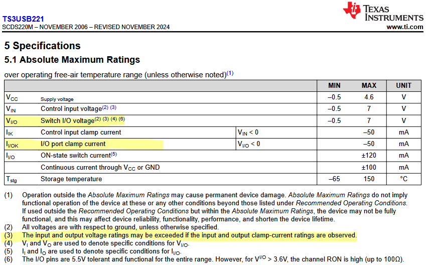

Does the TPD3S714 have a maximum clamping current for I/O?
In an open GND condition, I measure -0.6V at the I/O pins of the TPD3S714 with respect to its GND pin; which is beyond the Absolute Max Rating of -0.3V).  In this state, the leakage current is only 600uA.  The TPD3S714 worked fine after exposing the device to these conditions, but I'd like to confirm if it is OK for long-term reliability.
For reference TPD3S714 Abs Max Ratings:image.png
For reference, the type of parameter I'm looking does appear on TS3USB221 datasheet:

    There's no i/o current clamp to my knowledge.  The -0.6V is likely the diode from the ESD cell.
    I'm a little confused by your measurement.  If you have open GND, what are you referencing the IO pin to?  How are you measuring this voltage?

  • Hi Robert,
    The device was not designed to handle this loss-of-ground scenario.  While the ESD structure is there to protect against transient events, I can't guarantee -0.6V is acceptable for long term reliability.
    Eric
