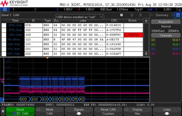

    We are experiencing an issue reported by our customer where, at some point during operation, our module appears to lose CAN communication completely and becomes unresponsive.
    Once this condition occurs, the module can typically be recovered by disconnecting and reconnecting its power supply. We have also observed that, in some cases, the module may recover on its own for a period of time before being used again.
    We would like to know if you have encountered similar behavior in the past, or if there are any known issues, failure reports, application notes, or field experiences related to this type of phenomenon with the TCAN1042-Q1 or similar devices.
    Any guidance, recommendations, or troubleshooting suggestions you could provide would be greatly appreciated.
  • Hi Yarelly,
    Please provide more information for this failure. For us to understand what is truly going on, we will need a waveform of the RXD, TXD, and CANH/L pins using an oscilloscope. There are many reasons that CAN communication could not be working as expected (software, improper schematic/layout, wrong transceiver mode, etc).

    Sure. For this testing, you have to put yourself in the perspective of the transceiver.
    With your failing case present, I would probe the TXD, RXD, STB, and VCC pins with an oscilloscope. TXD should show that the CAN controller is actively sending messages on the CAN pins. RXD should be "receiving" or echoing these messages right back. VCC/VIO should be on and present, and STB should be 0V. If this waveform looks good, then you will know the transceiver is not at fault. Everything else at this point will be system related.
    Another waveform to collect is the CANH and CANL pins during communication. It is possible that termination was removed negatively affecting signal quality. Or something else in the CAN harness was affected.
