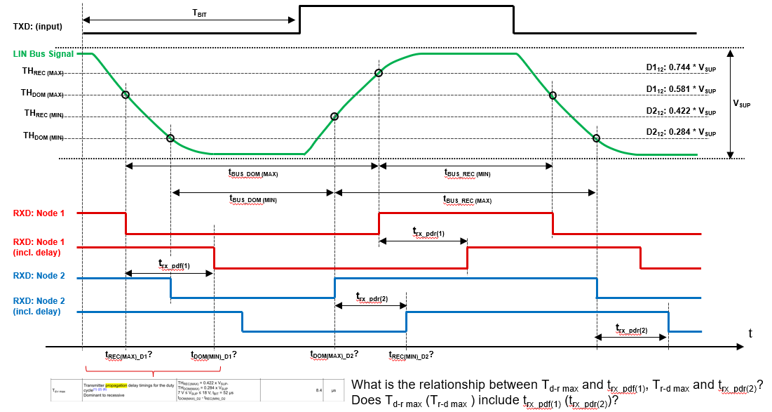

We would like to understand the timing parameters given in the datasheet, especially ones related to duty cycle D1 ~ D4. We are a bit confused with what are the relationship between these parameters and how we should use them when designing a system.
Below is the combined image of Figure 8-9 and 8-11.
Main questions are:
  • What is the relationship between Td-r max and trx_pdf(1), Tr-d max and trx_pdr(2)?
    • Does Td-r max (Tr-d max ) include trx_pdf(1) (trx_pdr(2))?

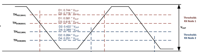

  • Based on Figure 8-11 and Td-r max spec in the Electrical Characteristics, it appears there is a discrepancy in the definitions: THREC(MIN), rather than THREC(MAX), is equal to 0.422 x VSUP, and THDOM(MIN), rather than THDOM(MAX), is equal to 0.284 x VSUP. Could you please clarify if this is an error in the text?

    1. These are two different segments of the total TXD to RXD signal path, not the same measurement. Td‑r max / Tr‑d max ("Transmitter propagation delay timings for the duty cycle") are purely transmitter‑side (TXD → LIN) delays. They are defined per the ISO 17987 duty cycle specification (Figure 8‑8/8‑9), and are computed from bus threshold crossing times. trx_pdf / trx_pdr are receiver‑side (LIN  → RXD) propagation delays, defined via Figure 8‑10 (test circuit) and Figure 8‑11 (propagation delay waveform), measured with a fixed RRXD/CRXD load. So, they don't include each other.
    2. You are correct, this does appear to be typo in Td-r max spec in the Electrical Characteristics. THREC(MIN) = 0.422 × VSUP, THDOM(MIN) = 0.284 × VSUP.
