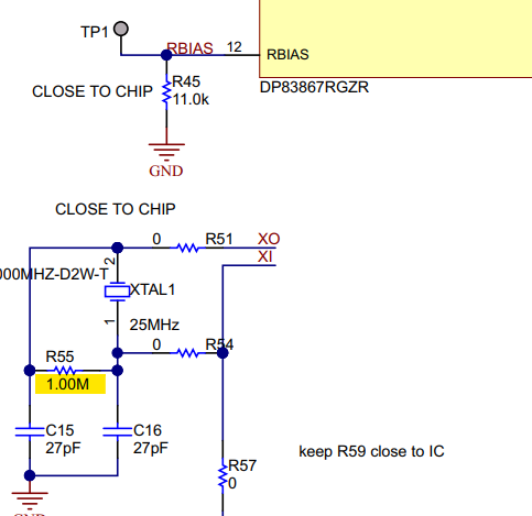

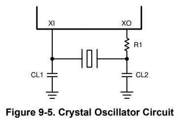

My customer uses a crystal between XI-XO.
Datasheet shows the crystal oscillator circuit. There is not a 1Mohm between XI and XO.
However, DP83867EVM has a 1Mohm between XI and XO.
When do they need this 1Mohm between XI and XO ?

    1) 1MEG resistor is common technique for xtal circuits for faster startup. This is dependent on xtal and use of this will need input from xtal vendor.
