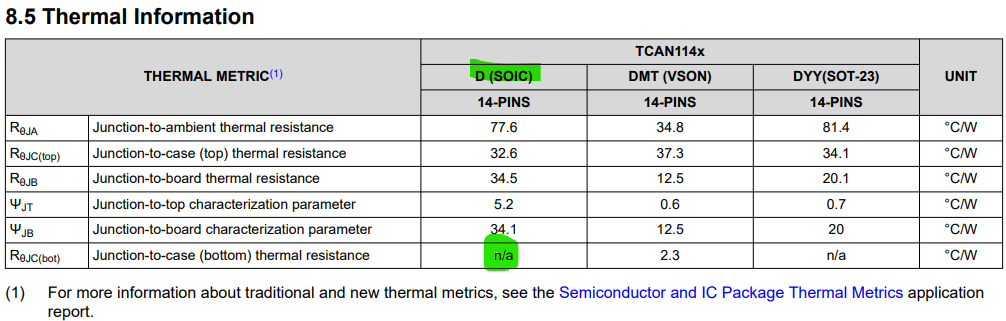

Do you have R_thetaJC(bot) for D pkg?

The junction to case bottom spec does not apply to the D package since it does not have a thermal pad like the DMT package does. This also applies to the DYY package.
