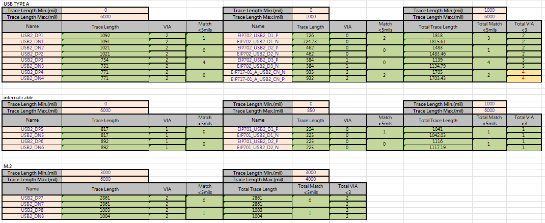

  • Hi Ryan,
    I would like to double-check a few points with you based on Table 5-4, Table 10-1, and my trace length table. If I am limited to the hardware pin-strap mode:
    eUSB:
    USB:
    1. If prioritizing the USB2 configuration (using Table 5-4): The eUSB2 registers will be forced to "Register Default". According to your previous explanation, this default is equivalent to the EQ setting for a 5-inch trace (i.e., E_EQ_Px = 2, etc.). Since my actual maximum eUSB2 trace length is only about 3.06 inches, would using the 5-inch compensation parameters cause slight over-equalization on the signal?
    2. If prioritizing the eUSB2 configuration (using Table 10-1): Could I select the 2.5-inch parameters (e.g., E_EQ_Px = 0), which are closest to my actual length, to ensure signal accuracy on the eUSB2 side? In this scenario, the USB2 side would fall back to the default configuration. Given that my USB2 trace is only 2.86 inches, would the default low compensation (such as Level 0) be sufficient to handle the insertion loss of such a short trace?
    Thanks!
    Jeff
  • Hi Jeff,
    No, the EQ settings on the eUSB2 lanes if configuring for USB2 should not be enough to cause over-equalization. 1dB of gain should not be enough to cause any large amount of over-equalization, so I don't believe there is concern there.
    Yes, you could use the 2.5 inch settings for the eUSB2 parameters in that case. E_EQ_Px = 0 still gives ~0.4dB of gain to the signal, so there would still be some amount of equalization being added to the signal.
    For USB2, the default register settings should be enough to cover for 2.86 inches in trace. Plus, you also have to factor in the loss that may be attributed to connectors or other components you have in the trace.
    It seems like you implementation is relatively low distance on both sides of the repeater, so I believe lower EQ settings would make more sense for your system. In terms of configuration, I do believe that it's better to tune for the USB2 PHY in this case, but I believe your system should be able to support either configurations.
