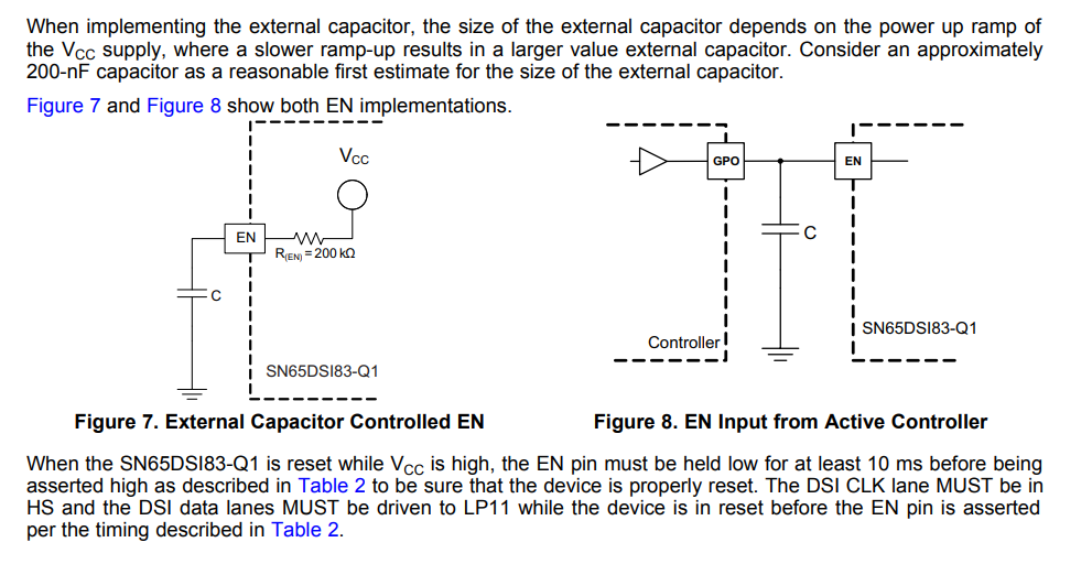

I have some questions about using external cap controlled EN in Figure 7.
  1. It looks capacitance depends on slew rate of VCC supply. How to estimate the capacitance?
  2. How to do 8.3.5 Initialization sequence or reset?
    You could test initially with the 200 nF capacitor as suggested and check whether EN is high 10 ms after Vcc power supply is high. You could use a larger capacitor to increase the rise time, and increasing the delay.
    You could also use a voltage supervisor device to ensure the power-up sequence is followed and that EN is set after Vcc power supply is high and stable.
    For resetting the device, you could initialize it fully again, by powering down Vcc. Or you could use the controller and use a GPIO pin to control EN so that you can set it high/low and toggle it for reset when required. Using the controller GPIO would be a recommended solution so that you have greater control for the EN pin.

  • Hi Ikram,
    If the customer use external cap only at EN pin, they need to find the appropriate capacitance based on VCC ramp up timing.
    Then, by adjusting capacitance, need to ensure 10ms before EN pin goes to HIGH. Is my understanding correct?
    Also, hardware reset is not possible if VCC presents. Is this correct?
    Yes this is correct.
    Are the customer not able to use a GPIO pin to control the EN pin? Since this device needs to be programmed via I2C, they could also connect a GPIO to the EN pin. Can the customer use a GPIO here?
