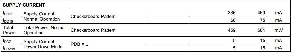

We are currently considering DS90UB947-Q1 in our design,
  1. Based on the datasheet , we calculated the power dissipation (PD) as shown below. Our display resolution is 1920 x 720 (60 Hz). Can you please confirm this calculation?
    Typical PD
    • 1.1 V × 335 mA = 368.5 mW
    • 1.8 V × 50 mA = 90 mW
    • Total = 458.5 mW
    Maximum PD
    • 1.1 V × 469 mA = 515.9 mW
    • 1.8 V × 75 mA = 135 mW
    • Total = 650.9 mW
  2. I am using single - link, 4 pair data + 1 clock pair , please provide the typical and maximum power dissipation for this configuration. Is there any method to calculate the Power dissipation value?
