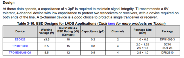

I am trying to protect the Y/Z output pins of the SN65LVDS31MDREP from ESD using a TVS diode.
Are there any ESD devices recommended for this output?
If not, do you have any information, such as the allowable voltage, needed for selecting the external TVS for the Y/Z pin?
