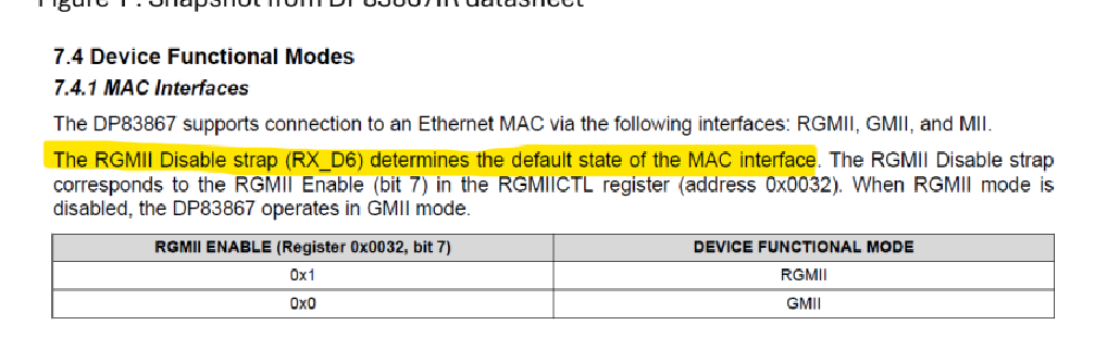

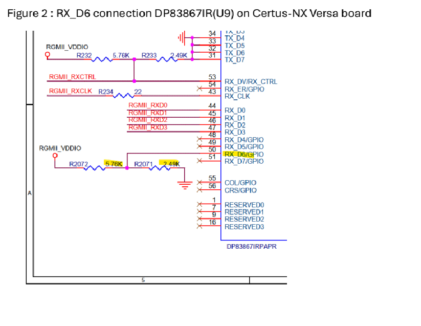

We are using the DP83867IR PHY.Please find the attached below schematic for strap configuration. According to the datasheet, RX_D6 is the RGMII Disable strap and maps to bit 7 (RGMII Enable) of the RGMIICTL register (0x0032). Our schematic shows RX_D6 strapped high, which should enable RGMII mode at power-up. However, the device does not appear to initialize in RGMII mode. Please help verify the strap configuration and identify any conditions that might cause the PHY to boot in GMII mode despite RX_D6 being strapped high?
