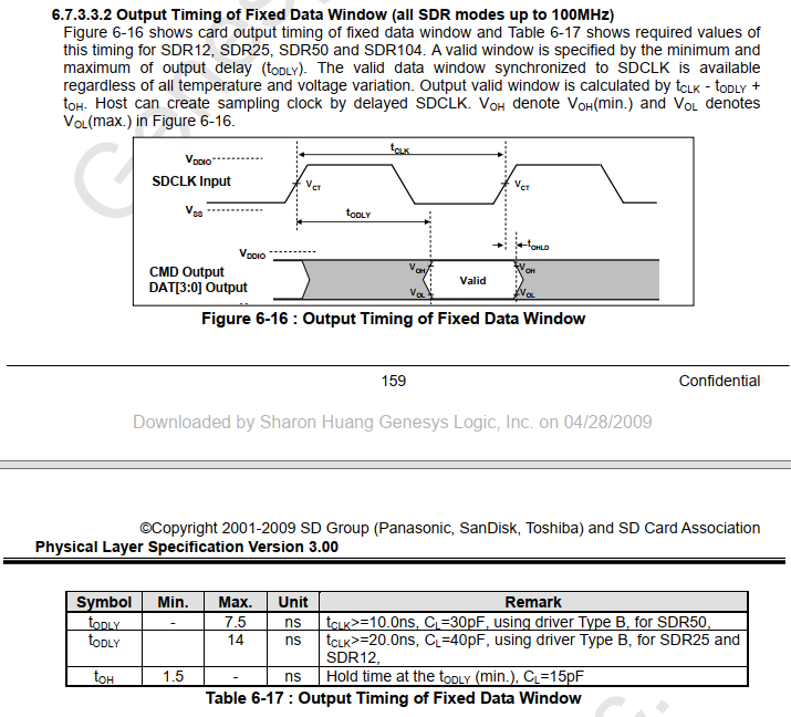

We use the MMC1 interface of am62a7 to conduct SDIO communication with the Wi-Fi module. Due to the need for sufficient setup and hold time, we adjust the phase of the clock through devmem 0xfa0810c. During the testing, we found that:
1. When the SDR104 mode was configured with CLK = 100M and devmem was used to adjust the phase, the establishment and hold times sent by the SOC, as well as the tODLY and tOH received by the SOC, could all be phase-adjusted.
2. When the SDR25 mode was configured with CLK = 50M and devmem was used to adjust the phase, the establishment and hold times sent by the SOC could be changed, but the tODLY and tOH received by the SOC could not be changed.
3. When the High-speed mode was configured with CLK = 50M and devmem was used to adjust the phase, the times sent by the SOC could not be changed.
In modes 2 and 3, we also tried to adjust the phase by regulating the itap write register, but the result was still unadjustable.
Under the above circumstances,
Since the measured tODLY and tOH values for the 50M mode do not meet the requirements, we plan to adjust the SDIO to 50M and adjust the phase to ensure that each time is in line with the standards of SDIO 3.0. However, neither the 2 or 3 mode currently configured is working. Could you please help us find out if there are any other solutions?

    Our actual application is that the other end of MMC1 is connected to the WIFI module. The CLK phase value is adjusted based on the establishment and maintenance time of the measured waveform. If we do not make the adjustment, the time margins of tsetup, thold, tODLY, and tOH will be too short, which may cause intermittent connection failures of WIFI.
    Therefore, we would like to know how to adjust the phase time under the 50M mode condition.

    • SDR104 @ CLK = 100MHz- Phase adjustment works (TX and RX): SDR104 has the DLL fully active on both the output (OTAP) and input (ITAP via tuning) paths. Therefore, adjusting the phase register via devmem correctly shifts both the TX output timing (tsetup, thold) and the RX input sampling point (tODLY, tOH). This is the expected and fully supported behavior.
    • SDR25 @ CLK = 50MHz- TX adjustable, but RX (tODLY/tOH) NOT adjustable: In SDR25, the output delay (OTAP) is active with OTAPDLYSEL = 0xF, which is why the TX output timing responds to phase adjustments. However, ITAPDLYSEL is fixed at 0x0 in this mode, there is no input DLL tap delay applied. Writing ITAP values via devmem or the itap register has no effect because the PHY uses a fixed half-cycle capture mechanism for the RX path at 50MHz. This is why tODLY and tOH cannot be shifted.
    • High Speed @ CLK = 50MHz- Neither TX nor RX adjustable: In High Speed mode (3.3V), both OTAPDLYENA and OTAPDLYSEL are marked NA, meaning these register fields have no functional effect in this mode. The PHY does not route the data path through the DLL delay chain at all. Therefore, neither devmem writes to OTAP nor ITAP registers produce any measurable change on the waveform. This behavior is by design and is documented in the AM62A7 datasheet.
