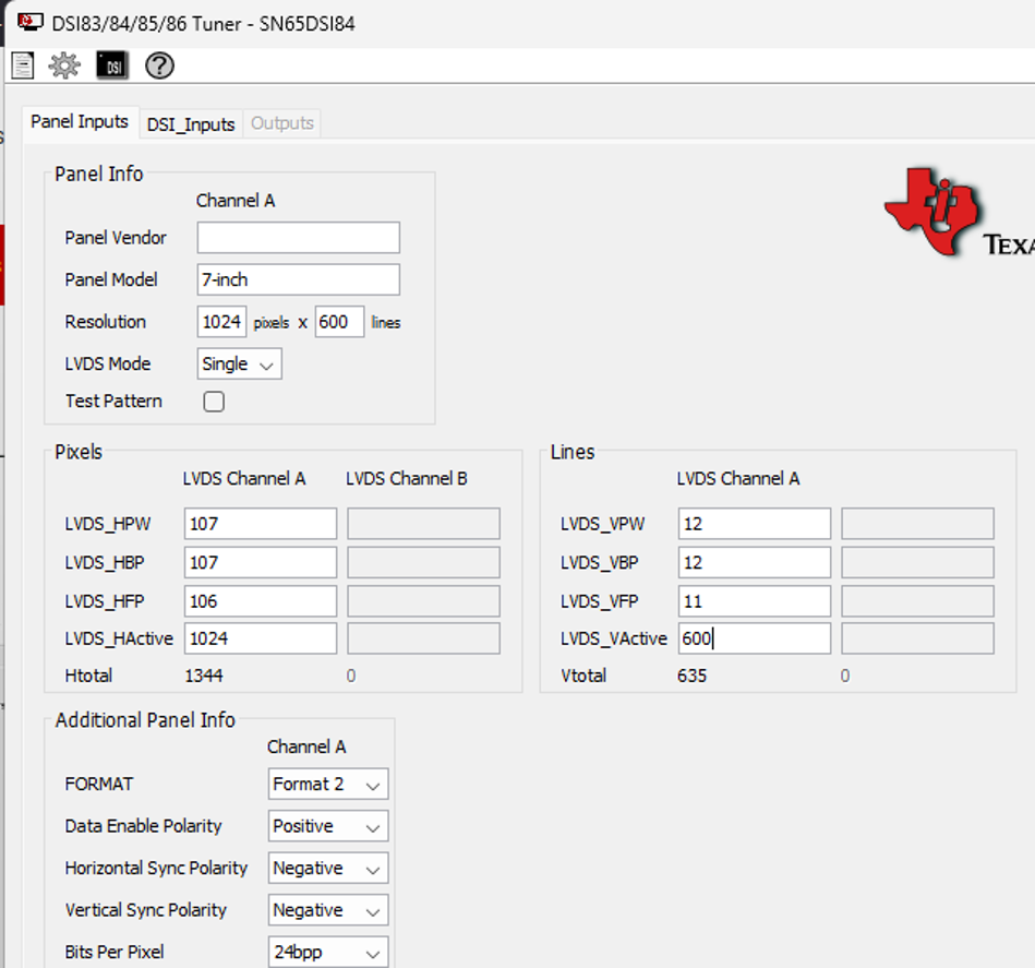

We are working with the SN65DSI for a display in an HMI application.  The DSI Tuner tool has been used to aid setting up the SN65DSI registers with values from the LCD's driver IC EK79001.
Hardware:
-1024*600, 7" display

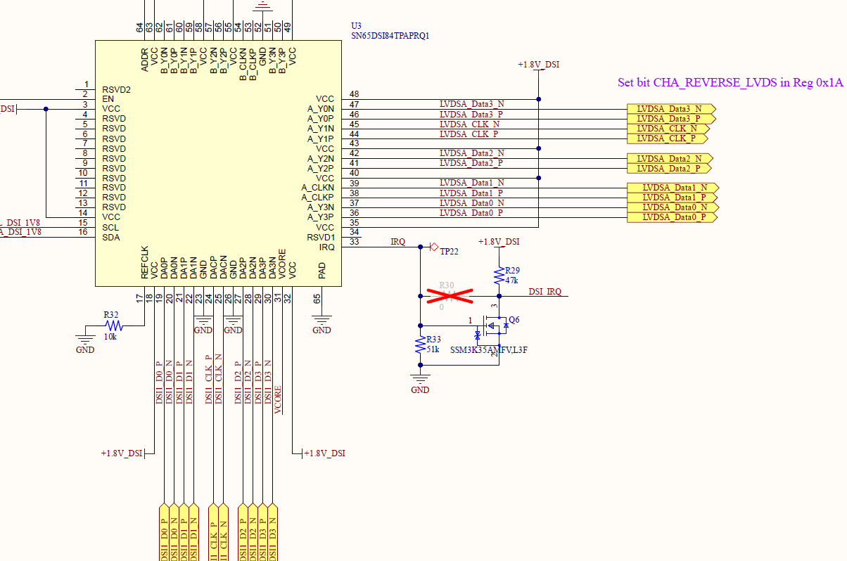

-SN65 LVDS output lanes are 'swapped' on channel A
-Raspberry pi Compute Module 4 is the DSI source
-length-matching and high-speed differential layout techniques were designed into the pcb
-10cm flat flex cable between the SN65DSI board and the raspberry pi module

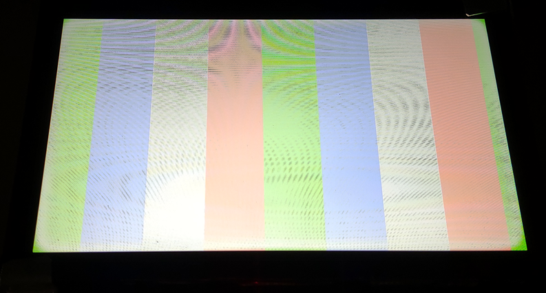

The test pattern shows up, but no DSI graphics data appears on the screen and there is a gray "arc" in each corner of the screen.
Sometimes the PLL error bit is set.
Any help on this issue is greatly appreciated!

    Test pattern mode
    The test pattern display is working as expected, is this correct?
    • Is there any flickering or any unusual artefacts with the test pattern output?
    • The output should be solid color bars like the image below. Is this observed on your display with test pattern?

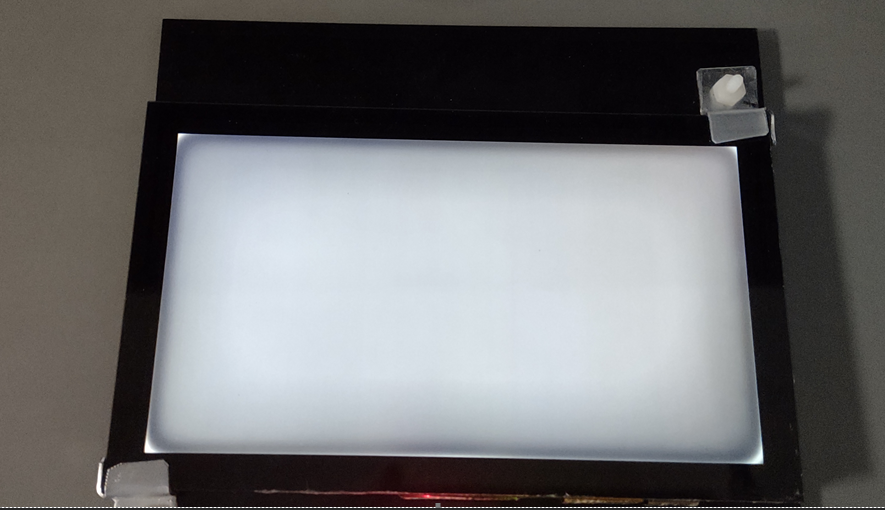

    With the DSI input, it looks like there is a white screen.
    • Is this the image being transmitted? Or is this the backlight making it look like a white screen? Try other images to send from source via DSI.
    • For the corner "arcs" is this being transmitted from the source or is it part of the display?
      • It seems like there are corner arcs with test pattern as well. In that case, this would be an issue with the display, because the DSI84 only send solid color bars test pattern only.

    The test pattern does show up, but the color bars aren't in the exact order you showed.  Is that a problem?
    Also, the colors are "washed out" and not very vivid.
    The screen should be displaying a GUI with buttons and graphs, but all we see is a white or gray screen, as posted above.  The corner 'arcs' are NOT part of the image we intend to display and we don't know why they appear in Test Mode or not.

    Test pattern:
    The exact order of the color bars may be different based on resolution, so this is okay.
    However, the colors should not be washed out. I think this might be an issue with the display. Could you please check whether the backlight and color settings are set as needed? The panel vendor might be able to help for this.

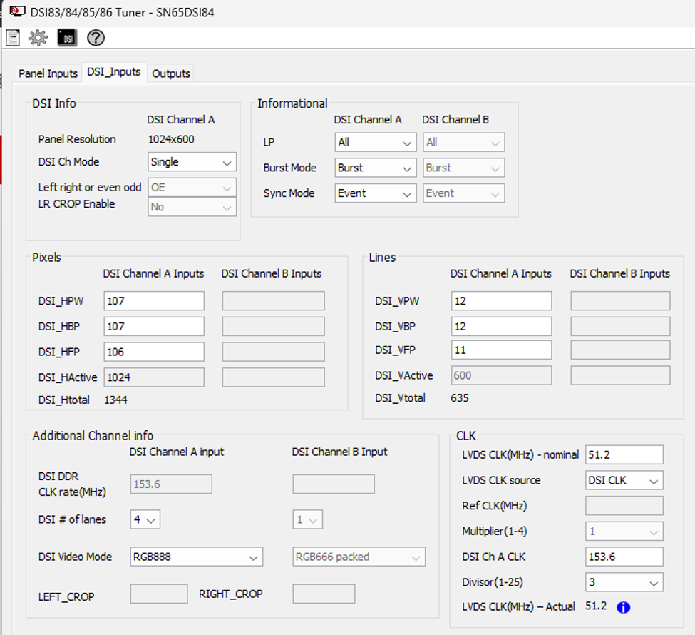

    I don't believe the LVDS clock should be the same as the DSI clock.  The DSI Tuner tool (see images in first post) says the DSI clock should be 3x the LVDS clock (LVDS nominal clock frequency is taken from the EK79001 datasheet).
    Yes, the DSI clock rate will be a function of the LVDS pixel clock rate.
    DSI clock frequency = (LVDS clock rate* bpp)/(2 * number of DSI lanes)

    1. The PLL unlock can be due to DSI clock not syncing, either because it is not in range, or because of SI issues.
    The DSI clock range, register 0x12 is set to 0x42 which falls in the 330 MHz - 335 MHz range.
    DSI clock divider, register 0xB[7:3] is set to 0x10 (bits 3 to 7), which corresponds to Divide by 3.
    This would give you an output LVDS clock rate of ~333MHz/3 = 111 MHz.
    Your initial panel entries show that you have an LVDS clock rate of 51.2 MHz, and DSI clock rate of 153.6 MHz. Please use these values instead.
