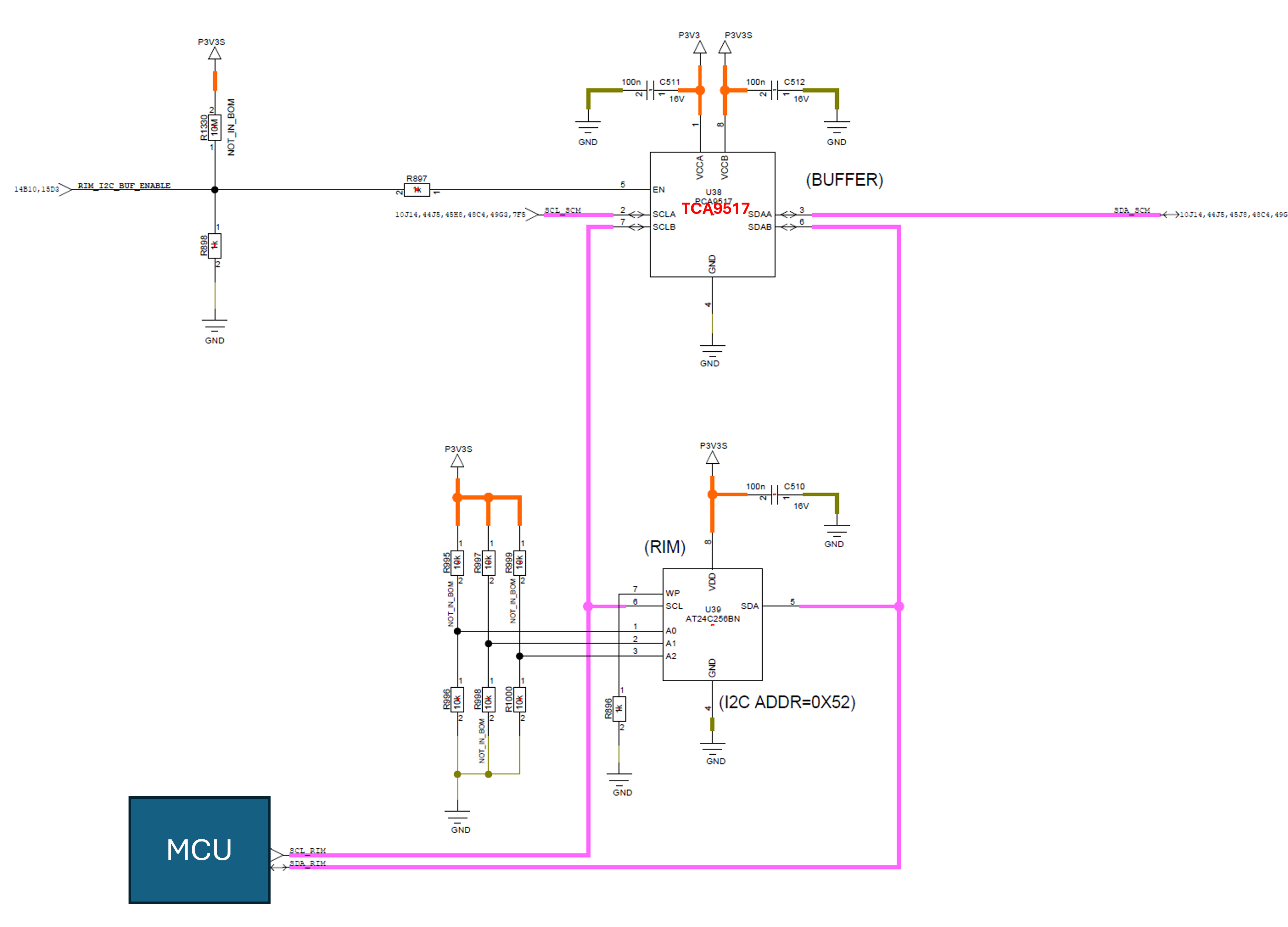

In the TCA 9517.png there is our schematic implementation.
MCU is able to reach successfully the AT24C256 EEprom, during the acces  the TCA9517 is disabled
 to avoid contention  .

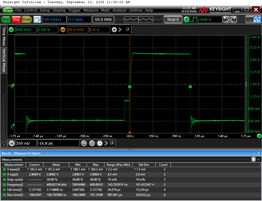

We can see on SCL_RIM and SDA_RIM a "flat" on relative Rise edge ( see SDA_RIM_Rise and SCL_RIM_Rise). This is not present when TCA9517 is not mounted. Is there a possible explanation ?
regard
Andrea Busi

    The voltage step looks to be ~800mV before rising to a VCC.
    Do you have a complete schematic to share with us? I would like to review what is connected to each side of the buffer as well as the pull-up resistor selection for the device.

    MCU is a LATTICE lfe5u-25f-6bg256i
    Pull up 1K @ P3V3
    ATC vendors :
    STM M24256-BRMN6
    ONSEMI CAT24C256WI
    9517 vendors:
    NXP  PCA9517ADP
    TI    TCA9517DGKR
    At the end we can see the flat on Rise time when TI is mounted only .
    No "Issue" with  either 2 flash vendors or NXP 9517
    I can confirm that we have never see failure on the bus with TI .
    But could be useful to understand this behavior
    Br
    Andrea

    Is it safe to say that the plateau is roughly 900mV to 1V?
    Also, do you have a waveform of the rising edge on the NXP device?
    I don't suspect that this voltage step will cause any issue because it looks monotonic. It wouldn't have risk to cause an i2c issue like a double clock edge.
