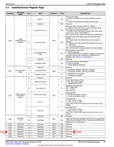

We're using the LMH1219 low power 12G UHD adaptive cable equalizer with integrated reclocker in our video equipment, running both 3G-SDI and 12G-SDI signals.
We're seeing video drop out over time, and on loss and reconnection of video. When this happens, Register 0x7 on the CableEQ/DivEQ page changes from 0x24 to 0xFF. This is the specific register change that correlates with video stopping. We're also seeing other registers change unexpectedly, but 0x7 is the one that breaks video.
This is occurring on some units but not others, all from the same manufacturing batch.
Can you tell us what Register 0x7 controls and what conditions would cause it to transition from 0x24 to 0xFF?

  • Hi Dajon,
    Are we certain the customer is not writing 0xFF to this register when the issue happens? From what I can gather, the device should not be changing the value in this register by itself.
    The fact that this is only seen on certain devices is strange as well. If the customer performs an ABA swap between a working board and failing board, does the failure follow the Device or the board?
    By video drop out over time, do you mean the Video stops transmitting from the LMH1219 after a certain point? How long does it take before video drops out?
    Shane
  • Are we certain the customer is not writing 0xFF to this register when the issue happens? From what I can gather, the device should not be changing the value in this register by itself.
    [Alex] That’s good to know. When this occurs, software should only be reading status – not performing any config. That said, our interim field solution is to disable all device access following initialization, in which case the video dropout issue has not been observed. So, we’re open to the idea that an intended read may, somehow, become a write. Albeit, so far, we haven’t managed to capture an SPI transaction that looks like a write on oscilloscope. Below are measurements of timing parameters, with the one marked in red now addressed in software that’s pending test (doesn’t seem likely to be the issue). Looking at how the software person implemented the protocol, I’ll likely seek clarification on a couple of things that the datasheet doesn’t confirm for me, but I’m currently awaiting another unit for further probing, and to capture waveforms for context. I should note that SPI devices are daisy-chained four-deep, with the first two devices being LMH1219 and the other two being LMH1218. The issue has, so far, only been observed for the second LMH1219 device in the chain.
    [Alex] We’re currently awaiting additional units from the field and could try this once we have enough.
    [Alex] We’ve been replicating by interrupting video to the device repeatedly and it can take a few, to many interruptions. Temperature also seems to have some effect (which makes it seem like it could be a timing or amplitude margin issue, but amplitudes look good and timing is as given above). We can restore video by writing the register back to 0x24. It can also be replicated by writing the register to 0xFF followed by a video interruption.
  • Hi Dajon,
    It seems this is tied to the value in register 0x7, writing a value here replicates the issue and reverting the value fixes the problem. If cutting off SMI access makes the issue disappear I suspect the customer's software is writing the register somehow.
    Looking forward to the ABA swap and software investigation results.
    Shane
