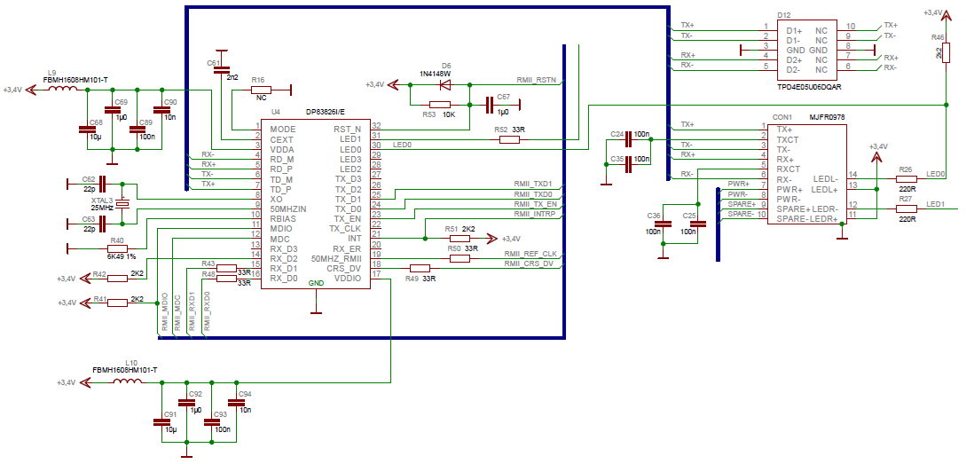

We are facing an issue with our design using the DP83826I. After an ESD event, the analog (bias) portion of the PHY appears to fail, while the digital functionality remains operational. The issue occurs sporadically during production and affects a small percentage of the devices.
During our investigation of this failure, we were able to reproduce the same issue by applying a 1 kV, 10/100 µs surge to the Ethernet pairs. In this case, the analog (bias) portion of the PHY was damaged, while the digital portion of the DP83826I remained fully functional. The RMII, management interface, and clock output continued to operate without any issues. We found that the surge caused damage only when the device was powered. When the device was unpowered, it survived the same surge without any damage.
The main symptom of the damaged device is incorrect bias on the TX lines. The damaged PHY is unable to establish communication with 100 Mbps switches, while communication with 10 Mbps switches still works. We also found an abnormal voltage on pin 2 (CEXT) of the damaged devices. On a properly functioning device, the CEXT voltage is approximately 1.7 V. However, the damaged devices show different voltage levels and behaviors on the CEXT pin. Some devices randomly alternate between 0 V and 1.7 V, while others remain at 0 V or show approximately 2 V with small voltage spikes. This indicates that the damaged devices do not all exhibit exactly the same behavior at the CEXT pin, although the CEXT voltage is abnormal in all cases.
As ESD protection for the differential pairs, we use the TPD4E05U06DQAR. After the surge test, we confirmed that the TVS device was not damaged. The TPD4E05U06DQAR survived the surge, while the analog portion of the DP83826I was damaged.

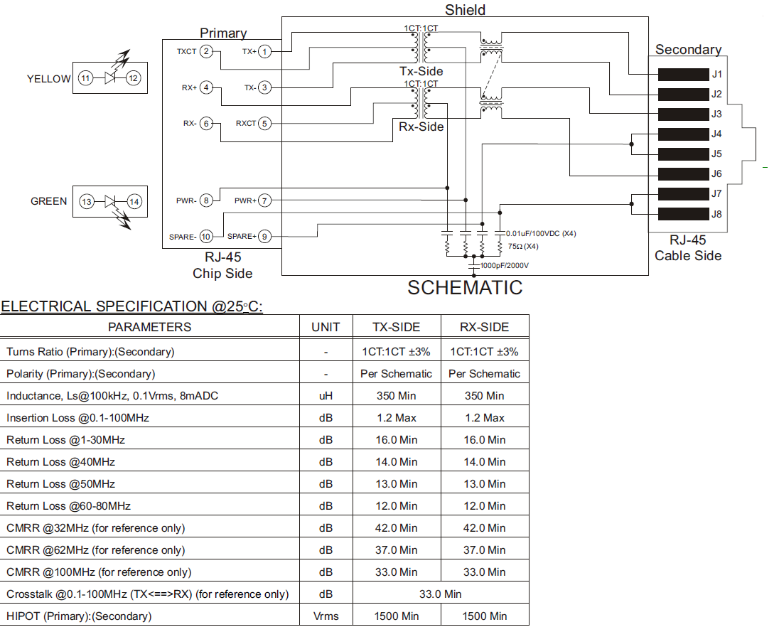

The schematic of the Ethernet section and the RJ45 MagJack used in our design are attached.
We would appreciate any suggestions or recommendations on what could be causing this failure, particularly why the analog portion of the PHY is affected while the digital portion remains fully operational. Could you also advise us on what additional measurements or tests you would recommend to help identify the failure mechanism?

    ESD is largely related to the layout design and GND routing/shield GND vs board GND isolation. Are you able to share the layout here? Particularly the segment between the PHY and the RJ-45 connector where the ESD strike is applied.
    The magnetics specs don't meet the DP83826A datasheet recommendations, yet if ESD is the only issue I don't think this would have much impact.
    For recommendations, I want to be sure that your RJ-45's shield GND is separate from the board GND where the PHY is located. Typically we use a 1Mohm resistor and capacitor in parallel to connect the shield GND to the board GND. You can see how this is done on the DP83826A EVM.
    Another recommendation I have is to switch from DP83826I to DP83826AI. DP83826A... is the newer variant of DP83826 with more robust ESD performance.
    Shane

    Regarding the RJ-45 shield, in our current design the connector shield is not isolated from the main board ground. Based on your recommendation, we agree that adding a 1 MΩ resistor and a 4700 pF capacitor between the RJ-45 shield and the main board ground could potentially reduce the surge return current flowing through the RJ-45 shield and board ground. During our test, we applied a 1 kV, 10/100 µs common-mode surge between the pair, with its two conductors shorted together, and ground.
    However, we are not sure that this would solve the entire problem. The device is a measurement instrument, and the main board ground is also directly connected to several other external connectors. Therefore, if the surge current is returning through the main ground via these other connections, isolating the RJ-45 shield from the main ground alone may not eliminate the current path through the PHY area.
    Regarding the DP83826A/DP83826AI, I understand that this version has improved ESD robustness. However, based on previous discussions with TI, my understanding was that this improvement was mainly related to maintaining communication during an ESD event, i.e. meeting the required ESD performance class A rather than class B, where communication is temporarily interrupted.
    Could you clarify whether the DP83826AI also includes improvements to the internal ESD protection structures or analog circuitry that provide physically higher ESD robustness of the device itself, particularly when the PHY is powered? This distinction is important for our case because we are not only seeing a temporary loss of communication during the ESD event. We are seeing permanent damage to the analog/bias portion of the PHY, while the digital portion remains fully functional.
