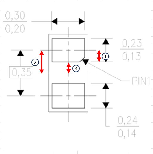

TPD1E01B04: [TPD1E01B04] Question Regarding Stencil Opening Dimensions
Part Number: TPD1E01B04
Hi Experts,
Under worst-case conditions, the distance from the centerline to the inner edge of the example PCB footprint ("3" on the table) appears to be greater than that of the thermal pad.
Could you please confirm whether sufficient solder coverage is ensured in this case?
Model No.:  TPD1E01B04
Package: DPL(R-PX2SON-N2)
Thanks.
