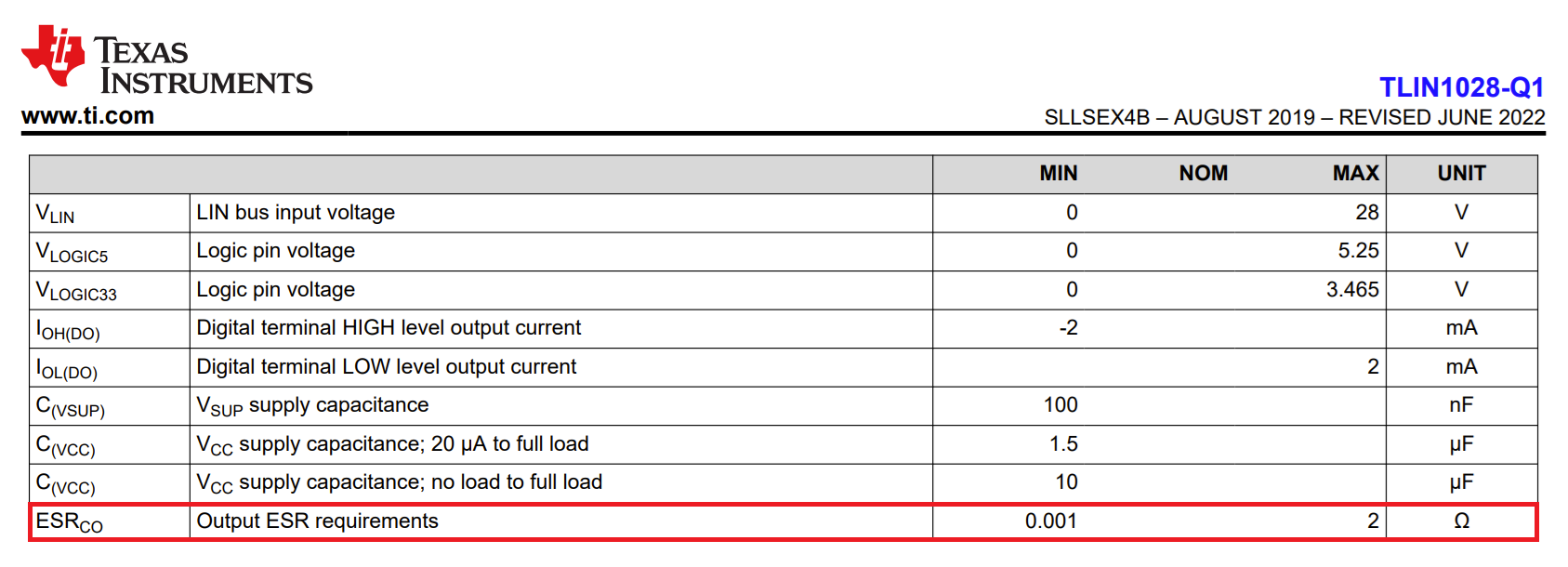

In the datasheet I can find ranged value of output ESR requirements as below ;
And my customer want to use the capacitors on VCC pin as below;

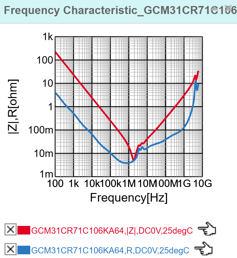

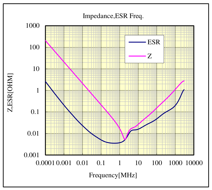

My concern is that in the capacitor's datasheet, ESR values are exceeded in particular frequency.
MCASL21GBB7106KTNA01 (Taiyo Yuden) -> Little exceeded in 0.0001MHz frequency
GCM31CR71C106KA64 (Murata) -> Exceeded under 200Hz and also 4GHz

    Although the TLIN1028-Q1 specifies an output capacitor ESR range of 0.001 Ω to 2 Ω, this should not be interpreted as requiring the capacitor ESR to remain within this range at every frequency shown in the capacitor manufacturer’s impedance / ESR plot. Capacitor ESR is frequency-dependent, and the relevant consideration is the effective capacitance and ESR of the output capacitor network in the frequency range relevant to the TLIN1028-Q1 LDO stability and load-transient performance.
    Both proposed 10-µF MLCCs may be considered, but the effective capacitance under the applied DC bias and temperature should be verified to ensure that the required VCC capacitance is maintained. Therefore, we would not reject the capacitors solely because their ESR curves exceed 2 Ω at very low frequency or at very high frequency as the caps appear acceptable, assuming the effective capacitance remains adequate and the capacitor network meets the <2 Ω ESR requirement in the relevant operating range, thanks.

    Furthermore as mentioned, the 0.001 Ω to 2 Ω ESR requirement in the data sheet is relevant at low frequencies near DC, because the VCC rail is a regulated DC output. The implied reference frequency for this ESR specification is approximately 100 Hz, based on the PSRR test condition in the data sheet (10 µF output cap, 100 Hz, 10 mA load). Hence, the ESR range does not need to be maintained across all frequencies from DC to GHz.
    Note that device uses a multi-loop LDO architecture where stability is not solely dependent on output capacitor ESR in the traditional single-loop sense and the design team has confirmed through transient simulation that the LDO remains stable across a range of capacitor values and conditions 2. The purpose of low ESR is primarily to improve load transient performance (minimizing voltage excursions during load steps), not to prevent oscillation 3.
    A high ESR at very low frequencies could slightly degrade the LDO's line / load regulation under transient conditions, but the specified limits (ΔVCC < 50 mV, ±2% VCC accuracy) should still be met with either of these capacitors 4.
    Hence, both capacitors are expected to work and may not need to find a capacitor that maintains ESR within 0.001–2 Ω across all frequencies as long as you ensure the effective capacitance under DC bias and temperature remains ≥10 µF if the load can transition from no-load to full-load, or ≥1.5 µF if the minimum load stays above 20 µA 3, thanks.
