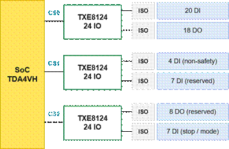

We are designing a new robotics controller based on the TDA4VH-Q1 processor. The design requires 64 high-speed GPIO signals with a switching time requirement of 100 ns for use in Digital Input (DI) and Digital Output (DO) functions:
GPIO Function
Required Frequency
DI (Digital Input)
200 kHz
DO (Digital Output)
10 kHz
Customer mentioned due to pin conflicts on the TDA4VH between SPI channels and other critical interfaces (UART, RGMII), available SPI resources are constrained. Our current plan is to use three (3) × TXE8124 SPI-to-GPIO expanders (24-bit each = 72 GPIOs total, covering the 64 required), all sharing a single SPI bus (SPI1), differentiated by individual chip-select (CS) lines.
Q1 – SPI Bus Speed / Throughput with 3 Devices on SPI1: With three TXE8124 devices sharing the same SPI1 bus (using independent CS lines), will the effective GPIO update rate be impacted? Specifically:
  • Each SPI transaction to one device requires a 24-bit SPI word. With 3 devices, the host must issue 3 sequential transactions per update cycle.
  • At 10 MHz SCLK, a single 24-bit transaction takes ~2.4 µs. Three transactions = ~7.2 µs minimum cycle time (excluding CS overhead).
  • Is this latency acceptable for the 200 kHz DI requirement (5 µs period)? Customer are concerned that 3 sequential SPI transactions may exceed the DI timing budget.
Q2 – Daisy-Chain vs. Independent CS Topology: Would a daisy-chain configuration (SDO of device 1 → SDI of device 2 → SDI of device 3) be more efficient for this use case? In daisy-chain mode, all 3 devices can be updated in a single SPI transaction (72 bits), potentially reducing latency. Please advise on the trade-offs.
Q3 – 100 ns Switching Time Compatibility: The TXE8124 datasheet specifies a digital glitch filter width (TGW) of 70–230 ns. For DI signals toggling at 200 kHz (5 µs period, 100 ns switching), could the glitch filter inadvertently suppress valid input transitions? Is the glitch filter per-I/O configurable/disableable?
Brian
  • Hello Brian,
    1) The latency is not acceptable for a 200kHz DI requirement. Since 7.2us > 5us period already exceeds the target period, the addition of the CS overhead will be stretch even further.
    2) A daisy-chain topology will actually be better since you will be removing the CS overhead. The MCU would only need to toggle one CS line as opposed to 3 different CS lines. However, the 10MHz clock frequency will still give you issues. Even if we eliminate the CS overhead to zero, sending 72bits with a 10MHz clock still results in 7.2us
    3)  To answer your first question, the digital glitch filter acts as a minimum pulse-width gate. Any input pulse or state transition must be longer than the filter width.
    To answer your second question, the digital glitch filter can be disabled. This can be found in the D0h register.
    Josh
