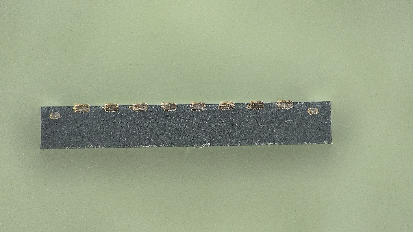

Could you please help me?
1. The markings on some of the microchips appear less distinct than on others, is this possible?
2. Furthermore, the leads appear to have undergone mechanical processing (grinding); or is this simply the result of the lead frame being manufactured via stamping?
    Yes this is possible, there are enough variations in the various processes here that the part markings on some devices can be more or less distinct.
    This is likely the result of the package singulation. Each individual package is separated from the lead frame strip during that process, and the edge isn't necessarily perfectly uniform. It is normal for the end result to have some visible texture.
