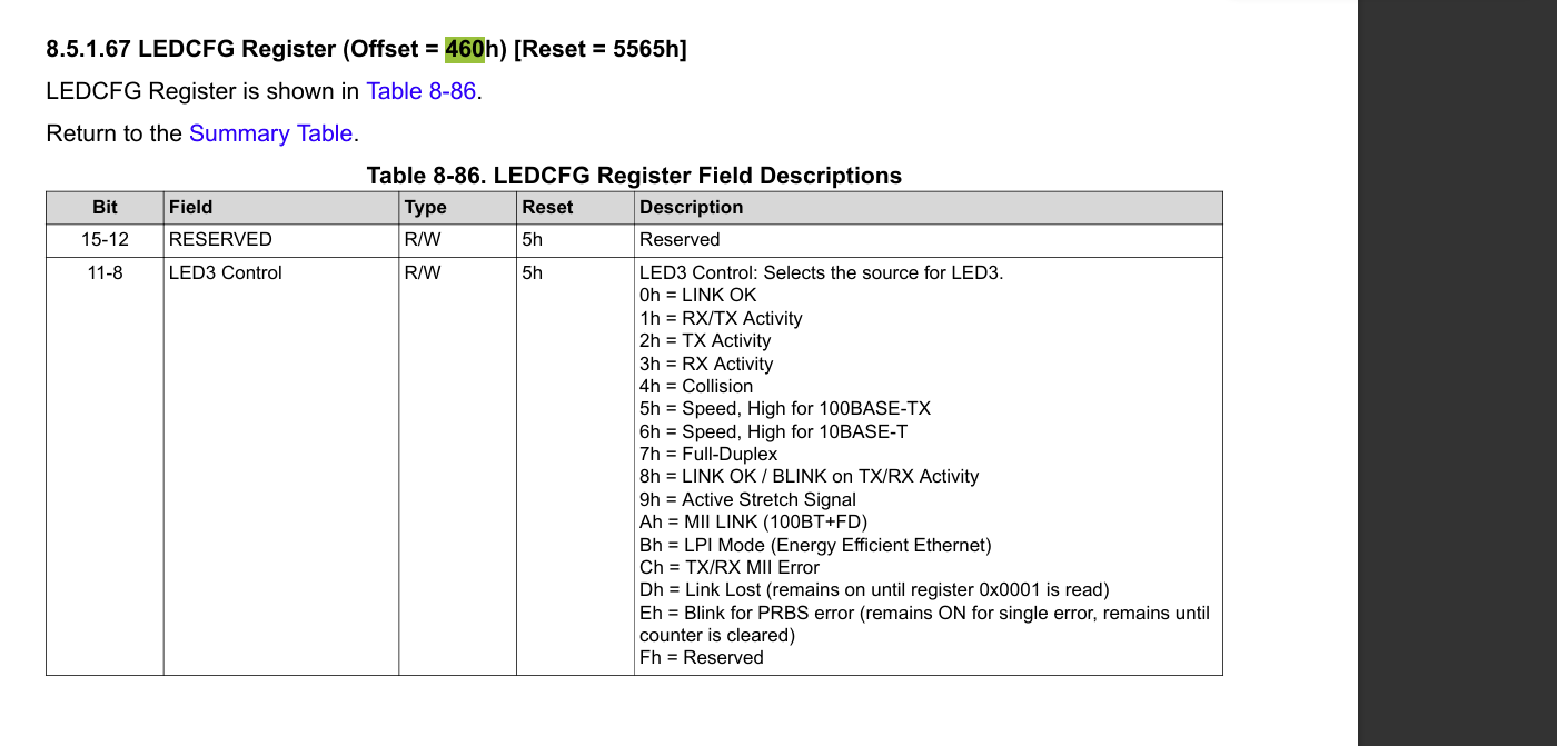

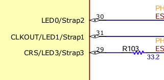

I wanted to configure LED3 to behave as LED1 in DP83826A phy , Can you please tell what should be done.
We want link status on led3.

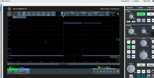

If I probe r103 i see toggling like this . image.pngI
From phy datsheet , we tried changing the following register 0x304 , 0x460 but there were not chagnes.
0x306 :
before : 14
after : 8
0x460
before : 1381
after : 101
but this dont have effect when i probed.

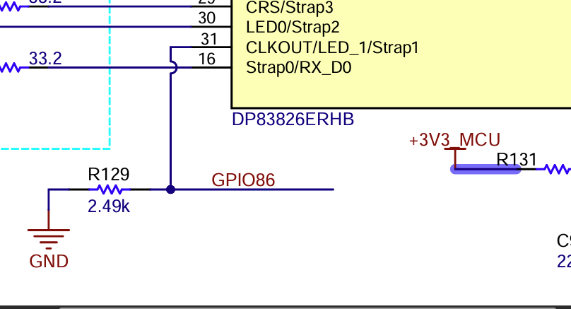

( I did similar thing in f28p65x device:
I probed led 1
When i probed r129 , it showed high when cable is conncted and 0 when disconnected . Then
in that i tried changing the led1 settings in 0x460 to different options but I observed the same thing .
Are there any additional steps to be done for the phy to get updated. ( I read back the register values and those were changed).
