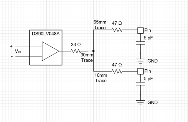

We are evaluating DS90LV048ATMTCX/NOPB at a supply voltage of 3.0 to 3.6 V and an ambient temperature of -20 to +85 degrees C.
One receiver output supplies BCLK to two TAD5212 DACs. BCLK is 12.288 MHz at a 96 kHz sample rate, or 6.144 MHz at a 48 kHz sample rate.
The proposed output network has:
- A 33 ohm series resistor directly at ROUT.
- A 40 mm common PCB trace.
- Two branches, each with a 47 ohm series resistor.
- Branch trace lengths of 10 mm and 65 mm.
- One 10 kohm pull-down resistor at ROUT.
Our preliminary trace model uses 63 ohm characteristic impedance and 7 ps/mm propagation delay. Each DAC input has 5 pF typical capacitance, with no specified maximum.
The total trace capacitance is approximately 12.78 pF. Including the two typical DAC input capacitances gives approximately 22.78 pF before other parasitics. This is a distributed network, not a single lumped capacitor. Frame sync uses a separate equivalent network.
Datasheet section 6.6 specifies propagation delay of 1.2 to 2.7 ns with a 15 pF test load, pulse skew of 0.4 ns, and channel skew of 0.5 ns. The disable test uses a 2 kohm load and 15 pF, with a maximum disable time of 14 ns.
Assuming the differential input meets the specified amplitude, common-mode voltage and transition requirements, please clarify:
1. Can the published minimum and maximum propagation delay and skew limits apply to this network at the stated frequencies? If not, what guaranteed limits or qualification method apply?
2. What timing reference should we use to separate receiver delay from external branch delay without counting the test-load response twice?
3. What maximum disable time applies with this network and a 10 kohm pull-down while the supply remains within its operating range?
4. With EN held low and the active-low enable input grounded, is ROUT guaranteed to remain high impedance while the supply rises or falls below 3.0 V? Are leakage limits available at intermediate output voltages?
The receiver and converter I/O share the same nominal 3.3 V supply. Loss of audio frames during a supply fault is acceptable. We require electrical isolation and safe restart.
We request applicable electrical limits, not general PCB approval. We will not use typical IBIS results as guarantees over the full voltage and temperature range.
Kind regards,
Jonathan Reichardt
  • Hi Jonathan,
    Just to be clear, you are talking about a setup something like this?
    Assuming that's roughly correct, here are my thoughts:
    No, the published tPHLD/tPLHD and skew values are specifically for 15pF loads. Practically we have to pick a load value for these specs, as it directly contributes to the rise/fall time of the output pin. Your ~22pF of capacitance distributed with various resistances would invalidate the test circuit assumptions.
    We don't have a specification for this kind of output network. Its possible to estimate this kind of delay, by treating these as a series of RCs, but there are some key assumptions you'd be making to do this on paper, and it still wouldn't constitute a specification in the same way out tplh and tphl specs are given.
    Practically speaking the time for the IO to become high-impedance is not controlled by the pullup/down. Those can affect when the voltage decay reaches 0.5V like what is shown in figure 18, but the device itself will still switch internally to high-impedance in the same amount of time. In other words, the high-z disabling will still happen in the same amount of time, but the RC characteristic if you observe it will look different.
    Items from the EC table that require the recommended operating conditions, such as the input thresholds, wont be applicable during ramp, but the truth table should still hold once you cross the threshold for the FETs to turn on. That said, we don't have a spec for leakage across supply voltage
