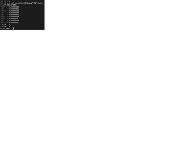

    1. Error flags:
    • When the video is not transmitting, what errors are flagged on the 0xF0 - 0xF8 registers?
    >>> Initially, error flags were set in registers 0xF0–0xF8. After modifying the driver, the error bits have been cleared, and currently only 0xF8 reads 0x01 (LT_PASS, indicating that link training succeeded).

  • Hi Gareth,
    Which registers should we check to verify the DSI input status and identify any reception errors?
    The main registers to check for errors are the 0xF0 - 0xF8.
    Are there no errors shown after initialization with DSI input? Please check whether the DSI errors keep recurring after the system is initialized. This could help narrow down the DSI input issue.

  • Hi Ikram
    >>>After system initialization was completed, three rounds of “read → clear → read again” were performed in DSI video mode. No error bits were detected in registers 0xF0–0xF8 (only 0xF8 = 0x01, indicating LT_PASS). No persistent DSI errors were observed.

  • Hi Gareth,
    1. If there are no error flags on 0xF0 - 0xF8, then no DSI errors are being indicated.
    How are you certain that the DSI video is sending actual video data? Could you try a different image output and check as well.
