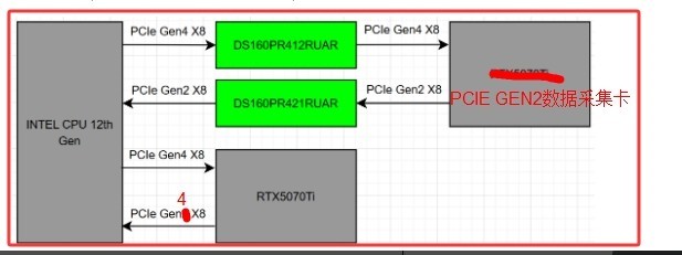

We use DS160PR421RUAR for our industrial board PCIe switch and DS160PR421 PCIe x8 slot is used with an RTX 5070 Ti graphics card and a data acquisition card for power-on/off testing.
Now, there is a problem of CPU PCIE bandwidth loss (from X8 to X4/X2/X1/X0). However, the PCIE X8 slots directly provided by the same platform CPU are not affected.
Please help to advise if DS160PR421RUAR can support NVIDIA RTX 5070Ti and why the bandwidth drop? thanks.
    We use DS160PR421RUARl for the PCIe4.0 redriver, and the block diagram please refer to below:
    Now, we test the PCIe communicate between the INTEL 12th Gen CPU( PCIe4.0 ) and RTX5070( PCIe2.0 ), the SMBus is not connect and the EQ0/ EQ1 connect to GND;
    Now, the isue is DS160PR421RUAR will bandwidth loss(X8 drop to X4/X2...) if we use the block diagram circuit,
    And there are no bandwidth loss if the CPU direct connect to RTX5070, however, DS160PR421RUAR connect to PCIe 4.0/ PCIe 3.0 board are also OK;
    As we know, DS160PR421RUAR is support the PCIe 1.0 to PCIe 4.0,
    We consider to know, the PCIe1.0 and PCie2.0 have any diffenert designs from PCIe3.0 and PCIe 4.0, if yes, please help to advsie how to modify our design, thanks.
  • Hi Zhang,
    Can you please share the schematic for the DS160PR12/21? Does this bandwidth loss occur every power-up, or only on some occasions?
    Greg

  • Hi Gregory,
    The below is the updated block diagram from customer for your evaluate, please kindly review our request, this is urgent because it is happen on the end customer and we need to comfort customer complaints, thanks.

  • Hi Zhang,
    Could you please help provide the strapping information for the device if the schematic cannot be provided? Determining which modes the device is strapped to will help with the debug.
    Greg
  • Hi Gregory,
    Plesae refer to below feedback:
    DS160PR421RUAR:
    PIN 41, MODE, Pull-down 1K resistor
    PIN 1, GAIN/SDA, NC
    PIN 40,EQ0/ADDR, Pull-down 1K resistor
    PIN 20,EQ1,  Pull-down  1K resistor
    PIN 42,RX_DET/SCL,  NC
    DS160PR412RUAR:
    PIN 1, GAIN/SDA, NC
