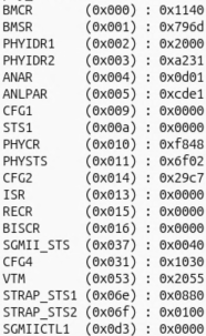

We are using DP83867 in SGMII mode on a custom FPGA platform.
We observe that when a PC sends large Ethernet packets (jumbo frames) to the DP83867, the PHY asserts XGMII_ERR_INT (ISR register 0x0013, bit[2]) at 10 Mbps and 100 Mbps operation.
Observed behavior:
- PC -> DUT
- 10 Mbps: XGMII_ERR_INT asserted for large packets
- 100 Mbps: XGMII_ERR_INT asserted for large packets
- 1 Gbps: No issue observed

1G
100M
10M
Any guidance on additional diagnostic registers to monitor would be appreciated.
