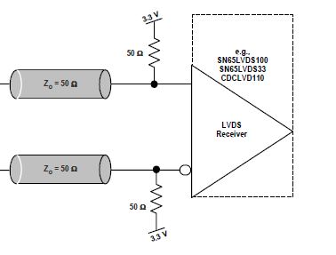

<see picture below> Are there any potential issues if the 3.3V power supply tied to the 50 ohm resistors is ON but the 3.3V power supply powering the SN65LVDS100 is powered OFF?

Unfortunately, the inserted picture is not present in the posting. Can you please re-post with the pciture.

I wouldn't expect any issues with this set-up. The input voltage will still be within the "Absolute Maximum" range (0 V to 4.3 V), so no damage to the device should occur. Even when powered off, the LVDS100 should have a high input resistance - see the "Power off input current" spec on page 3 of the datasheet for more information.
