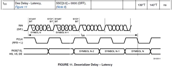

I'd like to know which value SN65LVDS86A has for 'Deserializer delay'.
For example, DS90UR906Q-Q1 has the specifiation of 'Des delay' as below.
(tDD=Deserializer Delay)
But, in case of SN65LVDS86A, I could find only 'CLK delay' in datasheet. I think it is not deserializer delay. Maybe It can be snown by  'Constant * Tc' like as DS90UR906.
Please let me know the specification of 'DES DELAY' for SN65LVDS86A.
