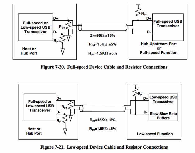

I'm building an isolated USB hub with the TI TUSB2036 and the AD
ADuM4160, which isolates the upstream port.
Problem: The hub isn't recognized. When removing the ADuM4160 and
connecting the upstream port directly the hub is enumerated. This
shows me that the basic hub circuitry is working. Clock, Reset and
voltages are correct.
The AD isolator chip is supposed to be transparent to the USB
protocol. The 1k5 pullup on DP0 is integrated into the isolator chip
and controlled through pin 12 (PIN, high=pullup active), so it is not
drawn in the schematics. I failed to find a suitable alternative to
the AD chip from TI.
Any suggestions? I'm completely open to alternative chip solutions.
