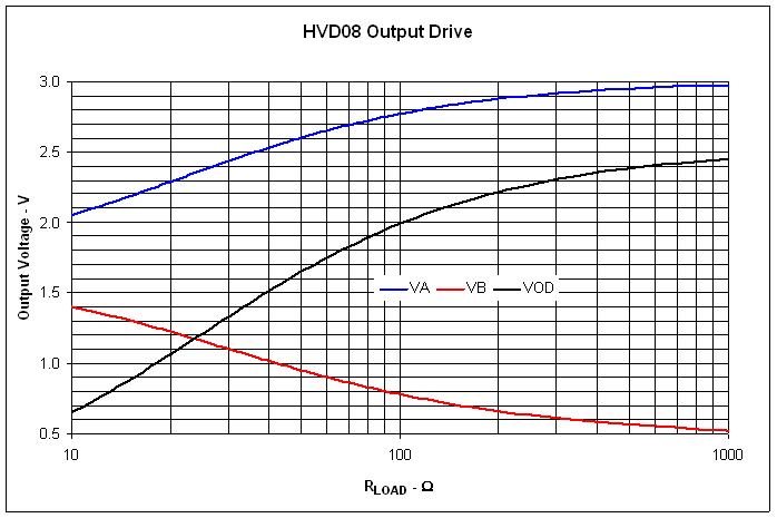

The SN65HVD08D appears to be unable to drive 1.5V differential output into a 54R load when powered from 3.3V. I've tested this with a 55R load, and only get a swing of 1.2V. When I remove the the SN65HVD08D and load a SN65HVD12D into the same circuit (also powered from 3.3V), then the SN65HVD12D doesn't have this problem and can drive a healthy 1.8V into the same load.  I've tested this with several parts that weren't from the same batch. The ICs' case markings appear to be correct.
Below is a table of some DC differential output voltage measurements I made with a SN65HVD08D driving various loads (resistors wired between the A and B terminals).  The part was powered from 3.3V and both the DI and DE pins tied to the same 3.3V rail.
Is anyone able to repeat my measurements?
Open circuit 2.58
22k 2.41
10k 2.25
2.2k 1.97
220 1.67
110 1.47
55 1.18

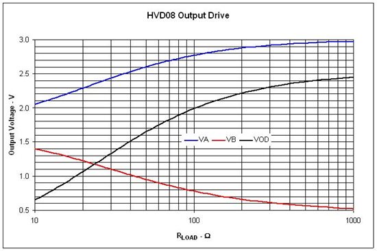

  • Paul,
    fortunately for us the taken load characteristics (see below) for the HVD08 does not confirm your measurements. The HVD08 provides a solid 1.7V at 54 ohm differential load.
    I have been informed that the HVD08 and the HVD12 in fact have the identical output stage. Also we confirmed a similar question through a scope shot back in March. If you search the forum for SN65HVD08 you should a query for March. In the response chain to our Asian support you will find the scopw shot.
    Regards, Thomas
