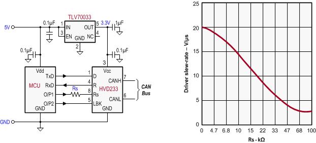

i need to design application based on 5V MCU that need to intreface with CAN bus.
our customer uses SN65HVD233 to implement the CAN bus.
I need CAN bridge that can tolerate 5V supply and 5V UART connection to the MCU, and ofcuorse can connect to the SN65HVD233.
please reccomend a CAN component to implement.
please send me a reference design for the CAN bus component.
  • While the HVD233 is a 3.3V device, its inputs allow for Vih to be 5.5V. Also the receiver output has a Voh-min of 2.4V which allows for a direct connection to a 5V controller. All you need is a low-cost LDO ,such as the TLV70033, that has a mximum input voltage range of up to 5.5V and provides a 3.3V, 200mA output with 2% accuracy. Then depending on your required slew-rate choose Rs and you are done.

  • For the HVD233 the pins are:
    Pin 1:  D (Data) = TXD = input from MCU to CAN transceiver to TRANSMIT DATA -- this is the pin that puts will translate digital data to the CAN bus (driver)
    Pin 4:  R (Receiver) = RXD = output from CAN transceiver to MCU RXD input -- this is ouptut of the RECEIVED DATA on the bus lines.

  • Functional Block diagrams page 1.
    Pull ups -- depends on your UART/MCU.  If it is push/pull IO you likely wouldn't need a pull up as it should adequately drive the inputs including timing.  If the MCU is open drain outputs you will definately need pull up on the D input to make sure that the CAN timing you want will be acheived.
