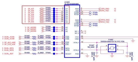

Due to TL16C2550 D0~D7 bus share with other device like : NAND flash.
May I know how to tri-state this data bus correctly ?

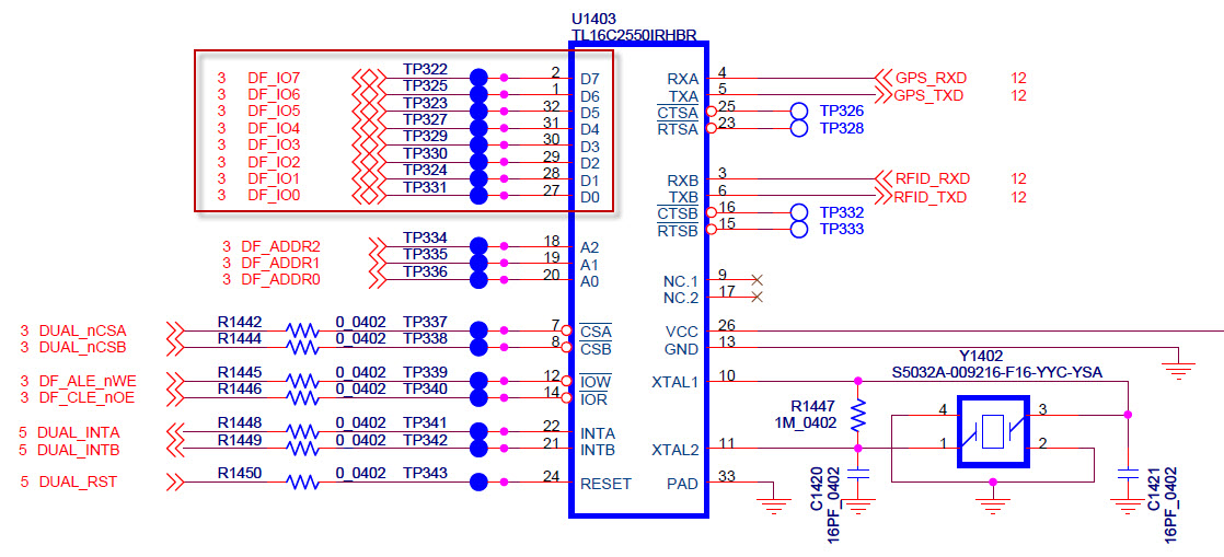

I mean the TL16C2550 D0~D7 data bus connect to CPU and a NAND flash.
So I need to tri-state 16C2550 before access the NAND flash.
How to config 16C2550's D0~D7 to tri-state ?

There isn't a register bit or external pin specifically for the D7-D0 pins. You would have to hold the 2550 in reset to tri-state the bus while accessing the NAND flash.
