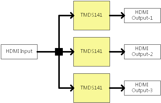

TMDS141 question
Other Parts Discussed in Thread: TMDS141
  • The HDMI input amplitude will now be significantly reduced as all 3 of the inputs are active, terminating the signal with 3 100 ohm load basically in prallel.  Also signal conditioning will be very difficult to manage as each of the TMDS141's represent a "stub" to the other 141's.  I do not recommend this configuration for this device.
