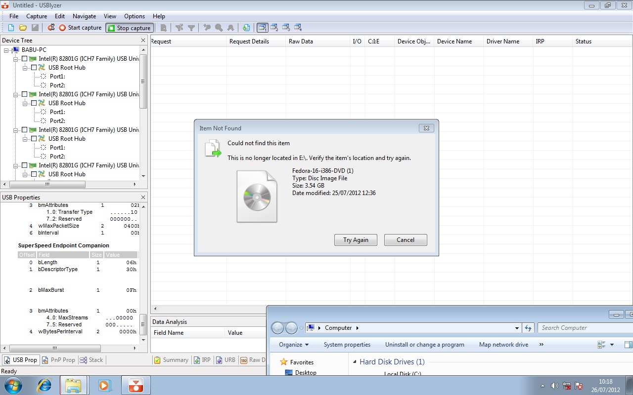

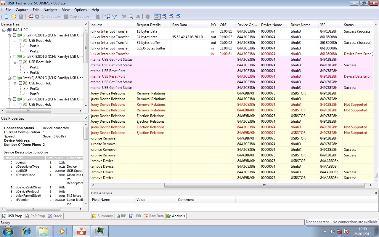

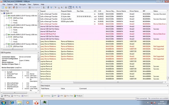

    And Now the main issues arises as below is the reason why I am working on it. It has been reported to me that when we transfer the data in bulk ( 2GB or higher) from USB3.0 to the SATA and vice verse, we get Device Data Error (Transaction Error) and then it resets the USB port and abort the transaction. I can observe this using USBlyzer tool. I can see 64K buffer sits between Hard disk and USB 3 and we get an error when it transfer data from that buffer. So I need to know that is this buffer provided by TI chip?
    I am also sending you the snapshot of error I got.
    Did anyone also reported this kind of issue?

  • Rosha,
    Would you please explain what is your requirement when you say "So I need to know that is this buffer provided by TI chip?"
    I can not duplicate your issue I have no problems with the evm running on atom, can you send a PCI register dump of the TUSB73X0
