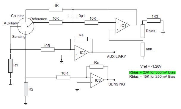

I recently learned about the LMP91000 AFE and was excited to use it in my application. However, I use 4-lead fuel cells from City Technology.
I was wondering if anyone has found a workaround to interface 4-lead sensors with LMP91000. If it's not possible, to use LMP91000, does anyone in Texas know if there are plans on developing a new AFE chip to intarface 4-lead fuel cells?
