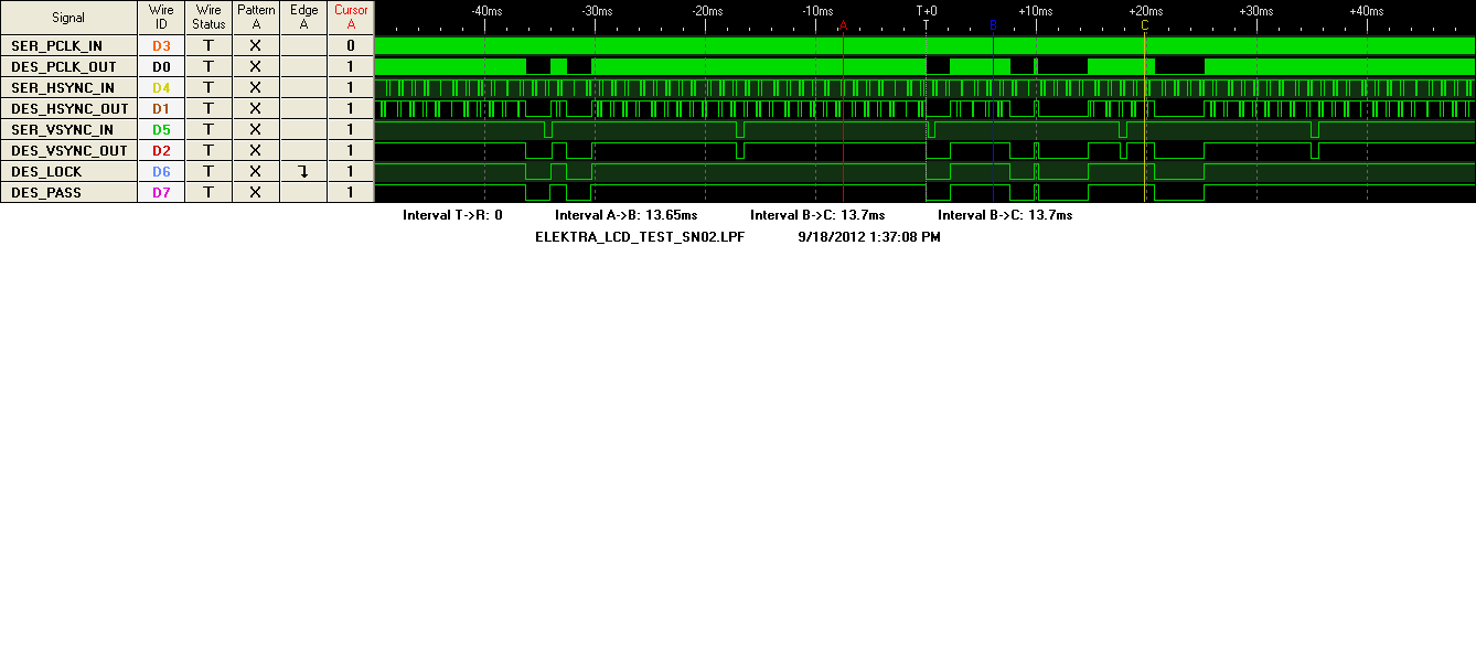

The issue I found was that the LOCK signal being asserted indicating a loss of clock recovery at the DS92LV2412 deserializer. This occurred with the pixel clock set to 10MHz. When I increase the pixel clock frequency to 20MHz the LOCK signal never asserted and my pixel clock output is uninterrupted.
Is there any reason that the DS92LV2412 deserializer clock recovery would fail at lower (< 10MHz) clock frequencies? This error might originate in the serializer. Any reason that the serializer would have issues with (< 10MHz) pixel clock frequencies?

    The serializer is receiving output from the LCD controller of TI AM3703 application processor. 24bit with PCLK, VSYNC, HSYNC as control signals. I have tested in BIST mode and the LOCK errors  are present in BIST mode as well.

    1). In your first post, you had specified: "When I increase the pixel clock frequency to 20MHz the LOCK signal never asserted and my pixel clock output is uninterrupted.". So it is my understanding that either at 20MHz or 10MHz or below you have not been able to get the device to lock at all. Could you please confirm.
    2). What are the configuration or strap settings. I mean pin # 13 and 12. Can we have copied of your DS92LV2412 and DS92LV2411?
    3). Is it possible if you could please send us picture or video of your test setup? A block diagram would be fine as well.
    4). Finally please send us register dump for both DS24LV2411 and DS92LV2412.
    Even though the device is rated at 5Mhz, based on our testing we should be able to operate even at lower frequency(i.e 2MHz). So we are thinking, perhaps, there is something in the setup that we do not understand.
