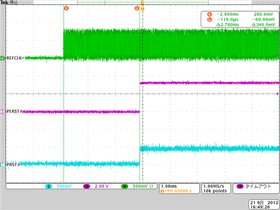

    The waveform of PCIE_CLK on starting up is below;
    The normal operating waveform is as below;

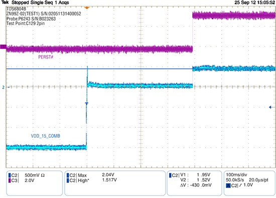

    But we found some abnormal waveform on the voltage on VDD_15_COM pin,
    The voltage after power on is 1.5V, but it increase to 2V after PERST# rised.

    your waveforms looks good, regarding the VDD15_COMBIO make sure your VDD15, VDD33 and VDDA are within limits.

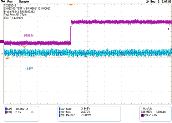

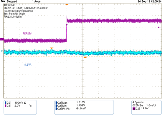

    However on starting up sequence, the +3.3VA(which connects to VDD_33_MAIN and VDD_33_REF_CLK) and +1.5VA(which connects to VDD_15_MAIN, VDD_15_PCIE, VDDA_15_PCIE_RX, VDDA_15_PCIE_TX and VDDPLL_15_PCIE) are unstable, as you can see each waveforms below;
    This phenomenon was resolved after removing the inductors L3 (between +1.5V and +1.5VA) and L4 (between +3.3V and +3.3VA).
    Should we remove these inductors?

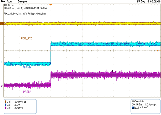

    Meanwhile, I could found out other abnormal phenomenon on TXN and TXP pins on XIO2001PNO after rising PERST#.
    On some cases, signal was output on these pins, but some cases not.
    Neither output this signal nor not, the PCI bridge itself is not recognized on HOST CPU.
    If you need to know more detail on each phenomenon, please inform me to have further proceed.
    Per specification both the PCIE Rx and Tx diff pairs should be AC coupled, the standard is to populate the AC coupling caps on the TX lines of each devices, in this way you will have always AC coupling caps in both TX and RX lines ( ones on the devices side and the other ones on the host side).
    In your schematic I don't see the AC caps on the host side, i.e. the AC caps that should connect with the PCIE_RX terminals of the XIO2001, can you check that? also the value is critical, they must be 0.1uF
    Are you getting a warning or yellow bang on windows? Can you send a screenshot? Also, make sure the resistance between REF0_PCIE and REF1_PCIE is the correct value.
