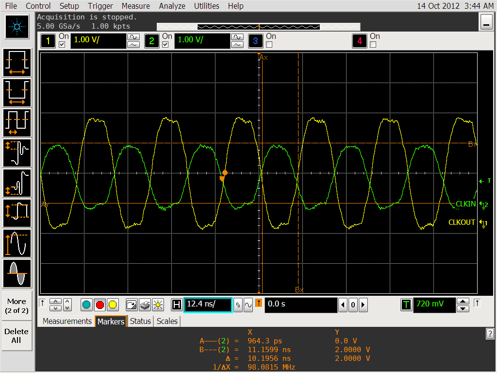

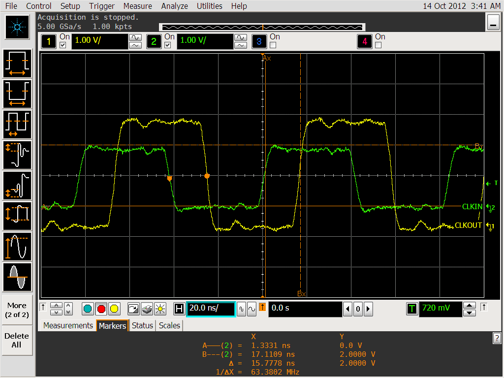

    I just noticed your post. It is my understanding that DS92LV2422 and DS92LV2421 are maintaining lock at high frequency but at low frequency occasionally we lose lock.
    Could you please monitor DS92LV2422 CLKOUT phase when you are at high frequency vs low frequency. Please use CLKIN of DS92LV2421 to trigger the scope.
    Regards,,nasser
  • Hi Nasser,
    As  described  they have problem with DS92LV2422 DS92LV2422 lose lock occasionally in low frequency
    Attached 3 pictures , 12Mhz, 24Mhz, 48Mz.
    Customer have no problem in 24MHz and 48MHz, but  have LOCK lose in 12MHz
     Note: The voltage level different because the VCC I/O different  (3.3V and 1.8V)
    B.regards
    Eli
