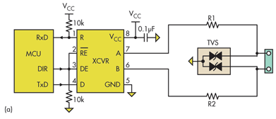

Hi Atul,
The IC's may burst when subjected to a heavy transient surge that is above what they are rated for. Typically, external transient suppression is used on the board (near the connector) for this type of protection.
This image showing TVS diodes as protection is from an article written by Thomas Kugelstadt (http://electronicdesign.com/article/power/onchip-transient-protection-74184).
I'm not sure what the application is, but does this sound like what is happening? Any more information you can provide would be helpful.
