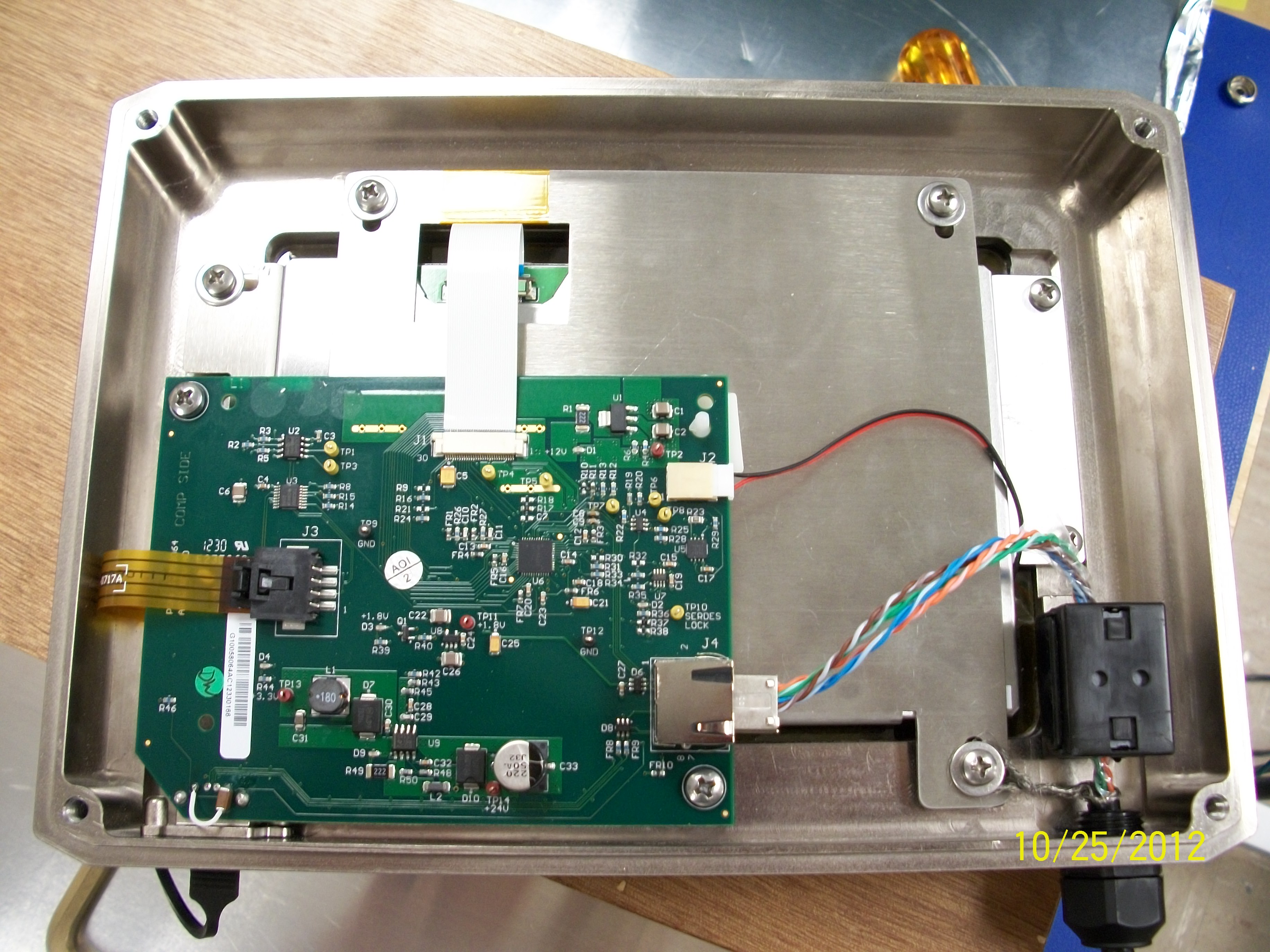

What is the best way to protect the LVDS pair from ESD? I currently have an ST Micro USBLC6-4 device at the Serializer and Deserialzer. This device has very low capacitance of 3pF. Is there a better application for ESD protection for this chip set or will the USBLC6-4 be a suitable solution?

  • The system that incorporates the Channel Link III chip set is a two box system. A Controller contains the processor board with the Serializer and a User Interface contains the touch screen display control board with the Deserializer. The two units are connected via a shielded 3 meter CAT5E cable. The cable has an M12 connector on one end for attaching to the Controller and the other end goes through a gland at the user interface housing and connected to the PCA via a shielded RJ45.
    With this setup, the M12 connector on the Controller will be subjected to ESD strikes during compliance testing and therefore protection on this port is required.
    To my dismay, I have verified that without the ESD protection devices, an ESD hit to the M12 connector destroys the Serializer chip.

  • Is your shielded RJ45 configured such that the shield/gnd makes contact prior to the signal lines, and if so, how is the shield on the CAT5E connected on either end of the cable?
  • Hi Mark,
    The RJ45 at both ends is shielded and connected to chassis ground. At the display end of the cable, the shield is connected to chassis ground with a ring-tongue connecter and screw. At the controller end of the cable, the shield is tied to chassis ground through the M12 connector housing. In both cases, the shielded is terminated as soon as possible to try and keep any radiated noise from entering the housings.
