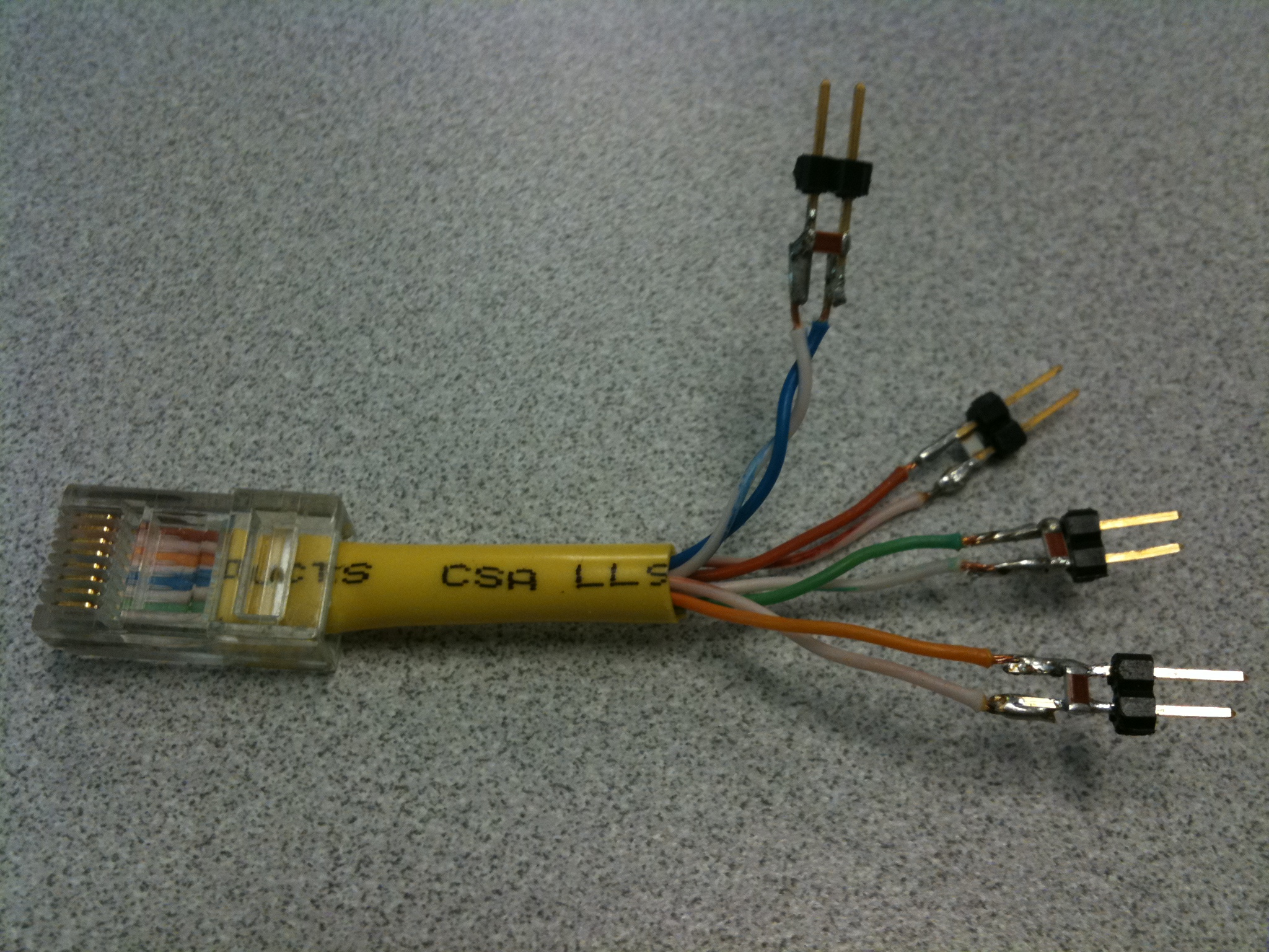

    Evaluate the signaling without a link.  For looking at output signaling, I generally use a short (1-2") pig-tail cable with 100 Ohm terminations.  With this cable plugged into the RJ-45 connector, the transmitter will be properly terminated and the voltage levels should be correct.  In this configuration, you can measure the transmit signaling.
    I have attached a picture of the terminated cable for reference:
    Evaluate the signaling with the device linked to itself.  To allow the link to connect to itself, you will need to create an external loopback plug.  External loopback (also called "line loopback") can be used to loop the high speed lines of the link back to themselves.  The easiest way to achieve this is by making a custom cable and plugging it into the RJ45 connector.
      1. Cut a cable with about 1 foot of cable and the RJ45 connector
      2. Strip off about 3~4 inches of the outside plastic shield to expose the 4 pairs of twisted pair cable
      3. Bend back pairs 4/5 and 7/8 (these will not be used)
      4. Solder pair 1/2 to pair 3/6
            1. Solder wire 1 to wire 3
            2. Solder wire 2 to wire 6
      5. Now you have a loopback cable.
    Plug the cable into any operating 10/100 Ethernet port and link will be established (assuming Auto-Neg is enabled).  You can also force 100BASE-T or 10BASE-T full duplex to test those modes explicitly.  In this configuration, you can measure the transmit signaling.
    I have attached a picture of the loopback cable for reference:

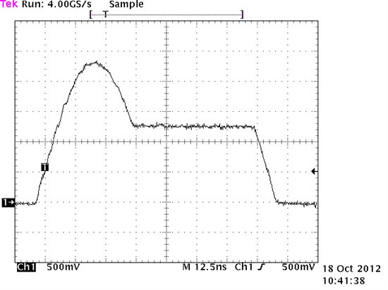

    Below are some representative signals that you can expect to see.
    Link pulses should be seen in 10M mode and in Auto-negotiation during link establishment.
    Scrambled idles should be seen when the device is forced to 100M or when 100M has resolved as a result of Auto-negotiation.
