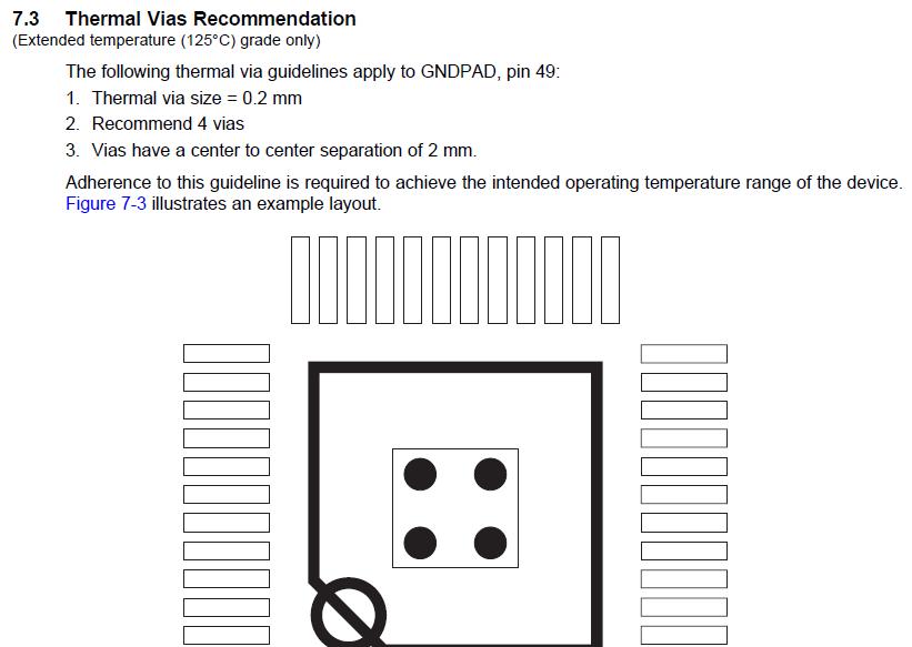

The information bleow is TLK110 GNDPAD (Pin49)
But I want real GNDPAD dimension.
Please inform me.

The TLK110 DS was updated and this section was removed, please look at th WEB for updated version.
The information you refer to was related to an extended temperture package, which is diferent part from the TLK110 PT part.
