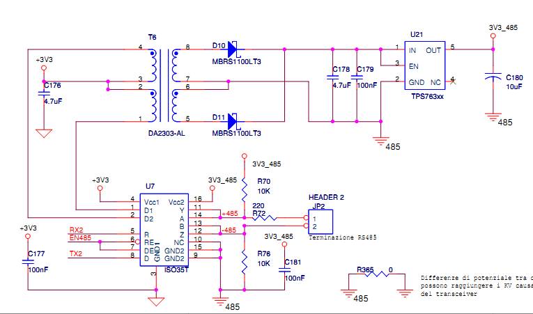

  • Joe Fockler said:
    can you send a copy of your schematics to me at jfockler@ti.com?
    The signals +485 and -485 drive the line. In addition there are two 10uH series inductors in the line. These are an inheritance of a previous design. I find it odd and I think they have been placed for over current protection. I tried to remove them but the signal edges do not change meaningful.

  • Thank you, Mario. The schematic looks OK. I don't see any issues with the schematic as shown.
    Can you send some oscilloscope shots of the R, T, RE#/DE, Y and Z signals?
    Joe

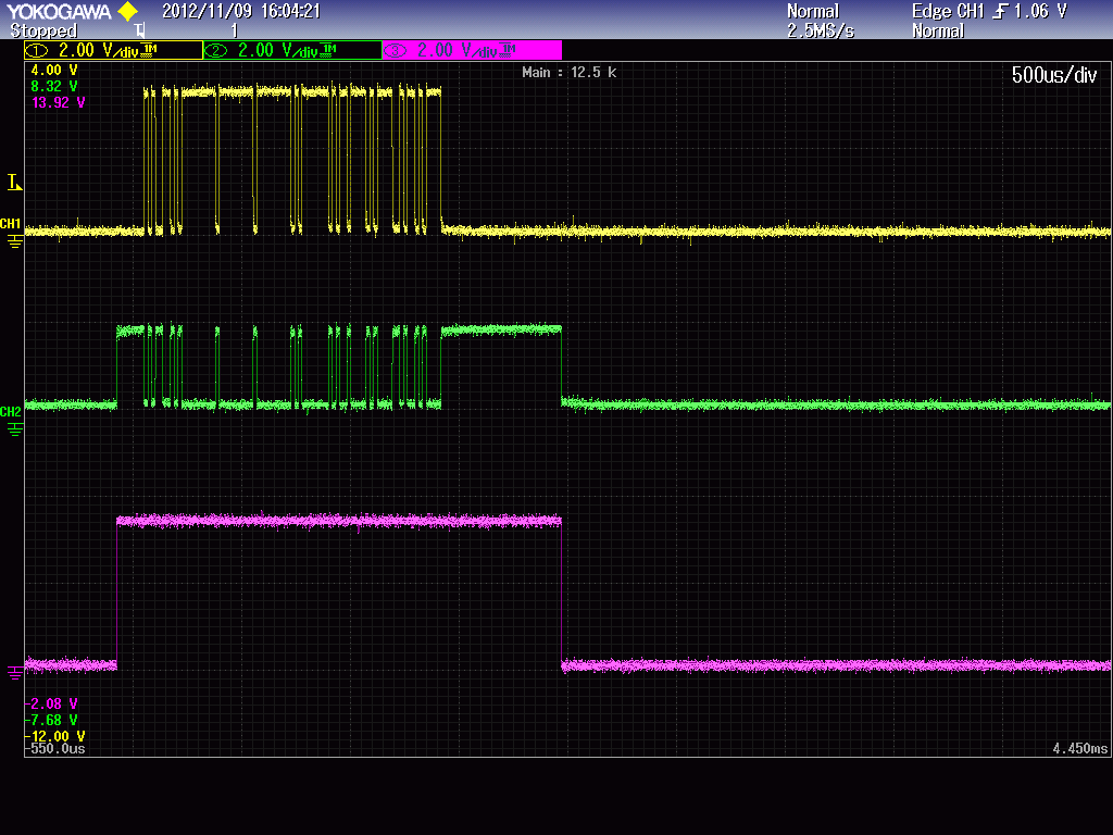

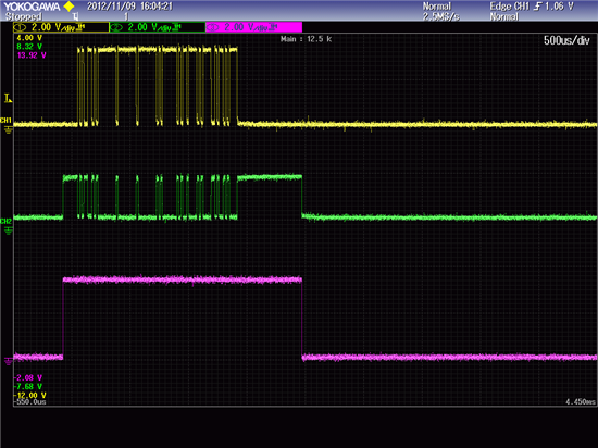

  • Thank you Joe.
        It seems that the ISO35T is damaged when I hot plug the 485 interface.
    In the first image I have the B-Z line in yellow, A-Y (green) and enable (pink). The A-Y has about a 2V range, when the ISO35T is healthy it shows 3.3V as the B-Z.
    After I hot plug the 485 the A-Y line is damaged and teh signal remains of 1Vpp even when I disconnect the cable.
    The device communicate with a second isolated ISO35T device an the isolated grounds of the two devices are connected.

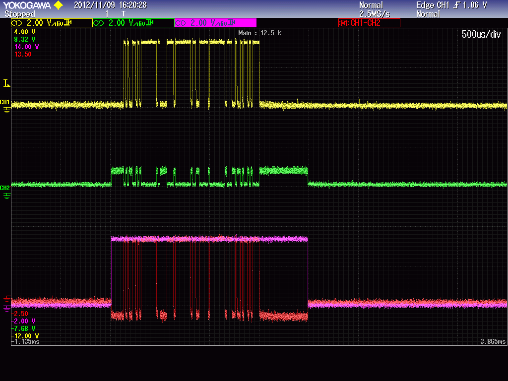

      Here the DE (Y) and T(pink)  and the Rx (half scale green) signals:
    I wonder about the reason of the dead of the line when I hot-plug the interface.
    Thank you in advance
  • The ISO35T is not designed for hot-plug applications. Hot plugging can cause undesired internal biasing of circuits, thus creating unwanted return paths in the device.
    The second scope capture of the enable signal is an example of what can happen when the correct power-up sequence is violated by hot plugging

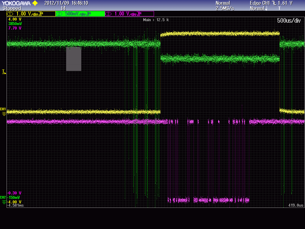

       According to the datasheet the lines are protected against over-voltages. I suppose the slave takes too current.
    What is the correct power-up sequence? When I hot-plug the master is already powered.
    In the second snapshot i put the difference signal A-B superimposed with the enable signal, but the enable looks fine.
    Is there something I can do to protect the IC against hot plug?
  • The correct sequence would be to have GND1 and GND2 potentials applied before applying Vcc1 and then Vcc2. So when unplugging the ISO35T or plugging it into a new board, the power lines must be energy free.
