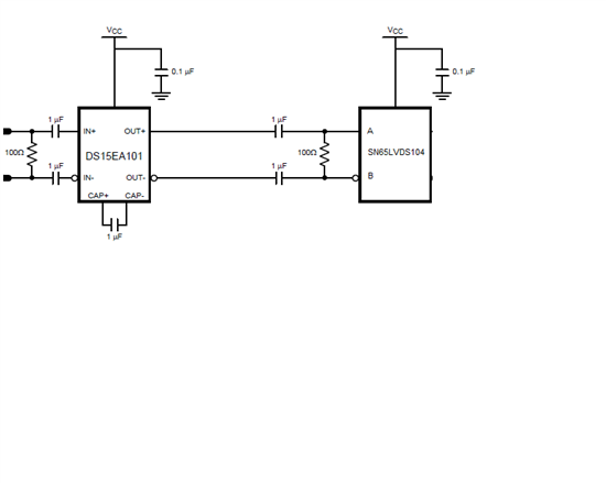

Please advise me on usage of SN65LVDS104 in AC coupling input mode.
When output of DS15EA101 is interfaced to DS65LVDS104 (as a fan out buffer)
The output common mode level of DS15EA101 is ~2.9V which exceed ANSI EIA/TIA-644
(up to 2.4V). So, AC coupling is required.
When SN65LVDS104 is sued in AC coupling mode, can this device be used without any external bias network?
