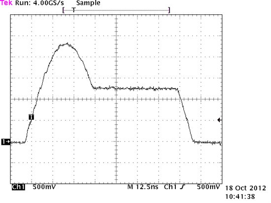

I face some problem on DP83848 that stuck me for a week. My Atmel SAM3X8E MCU can communicate with the DP83848, I can read the PHY ID and it is correct. But when I restart the auto-negotiation, the auto-negotiation complete flag never set.
For additional, when I plug in the Ethernet cable, the LINK and ACT leds are not light up, only the speed led light up.

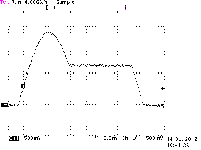

    1. Evaluate the signaling without a link.  For looking at output signaling, I generally use a short (1-2") pig-tail cable with 100 Ohm terminations.   I have attached a picture for reference.  With this cable plugged into the RJ-45 connector, the transmitter will be properly terminated and the voltage levels should be correct.  In this configuration, you can measure the transmit signaling.  I have also attached a picture showing the expected link pulse that should be measured.

      Plug the cable into any operating 10/100 Ethernet port and link will be established (assuming Auto-Neg is enabled).  You can also force 100BASE-T or 10BASE-T full duplex to test those modes explicitly.  In this configuration, you can measure the transmit signaling.
    Once we have confirmed the device configuration by reviewing the registers and we have confirmed the baseline transmit signaling, we should have a good understanding of the functionality of the device.  If the device is functioning correctly, we can then move to the partner testing to determine what is happening with the partner.

    Link pulse waveform:
