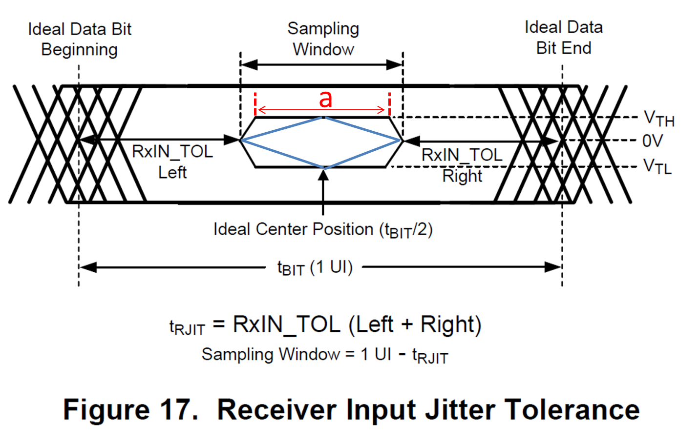

I would like to ask about sampling window of DS92LV2422.
Please see attached picture. I would like to discuss about the duration of "a". How much is this duration "a" shortened when the slew rate is getting worth?
The sampling window will be diamond shape like blue line in attached picture if the receiver sample the input data at ideal center position, but the center position will be misaligned from ideal obviously. So I believe that I would like to know the minimum duration of "a" if I can know the accuracy of sampling timing. Can we know any reference information from related documents?
