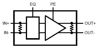

    2, Block diagram for DS15BQ101 like below

  • The datasheet for the device states that the single-ended output voltage for a "25 ohm load" when Rvo is set to 487 ohm is 800 mVpp. Should that a 50 ohm load?
  • Hi Mark,
    I reviewed the datasheet and compared it with the DS30BA101. You are correct, the device is designed to drive a 50-ohm load for each polarity, so the spec should be for 50 ohm load instead of 25 ohm load.
