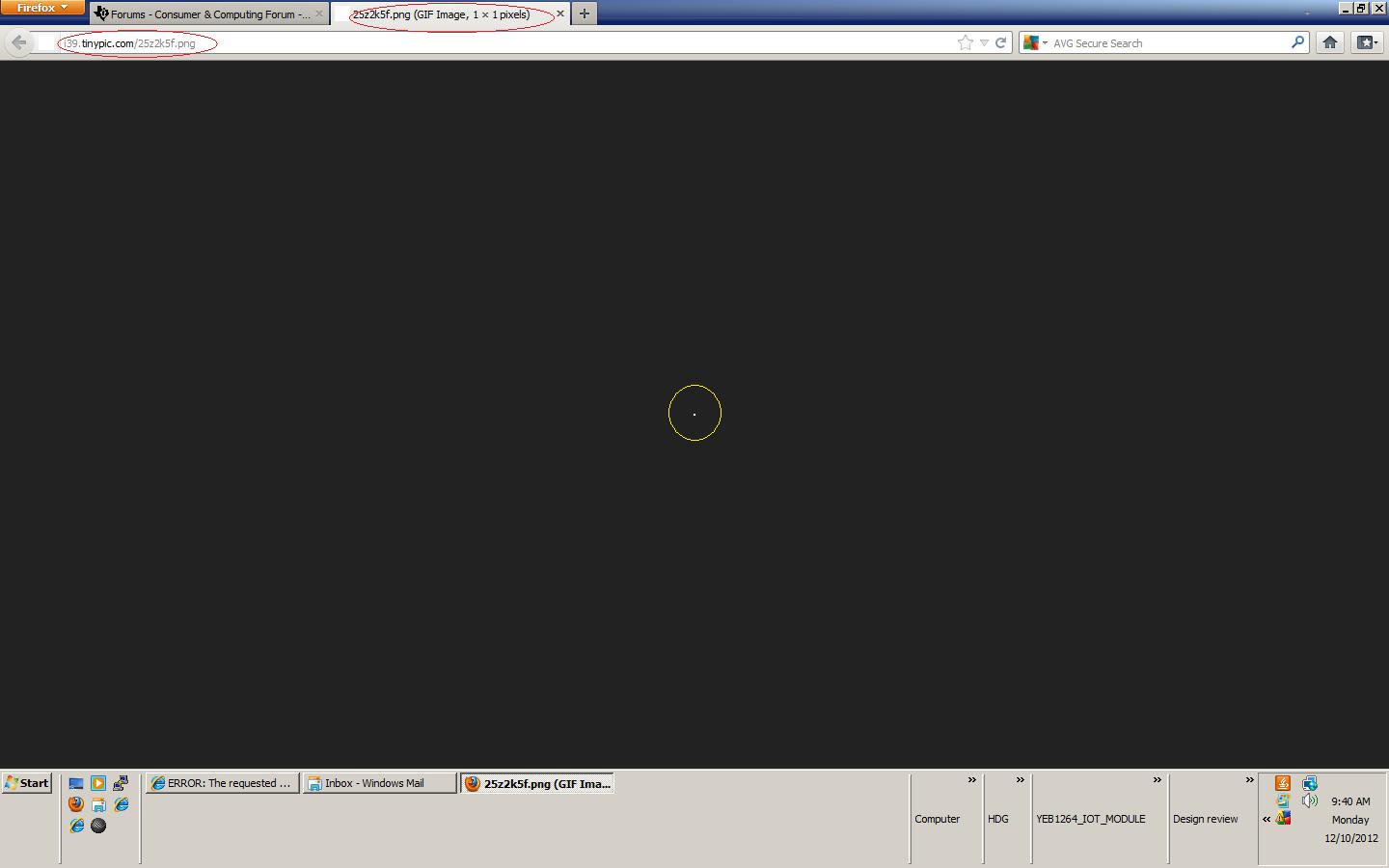

  • Hi Rosse,
    Thanks for your immediate response.      Did you sent any picture in the " http://i39.tinypic.com/25z2k5f.png" ? (I see only a pixel in that link).
    Kiruba
  • Please try IE.  It should work.
    RE
