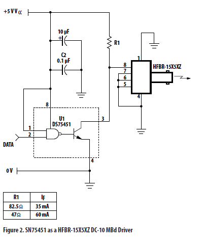

    For my design I need to switch a current through a transmitter LED. The current is about 30-60mA. I't would be nice to find a 5 gate inverter with open collector output. With 5 och 3.3V supply.
    And it would be nice to have the same dalay time (18ns).
    The SN75451BD is used in the following example for the transmitter LED:

    The ULN2003LV would be the lowest cost solution, but it may not be fast enough.
    You could try using analog switches with one side of the switch connected to ground.
    I attached a list of SPST switches that have an on/off time less than 18nS.
