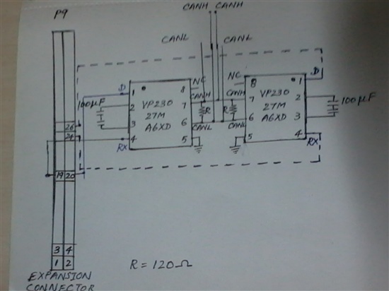

 We  have interfaced SN65HVD230  with Beagle Bone's CAN Port and  the CAN Tx line is staying at High  when we are sendingd data.We are connecting in loopback mode with  one CAN transceiver CANH tied to other transceiver's  CANH and similiarly  for CANL also.  Is there any limitation for SN65HVD230 to work with other TI's microprocessors with CAN support. The datasheeet shows operation with TMS320LF243  and is it limited to this proceesor or this is a generic transceiver ?

            We belong to the software team of Ajish who posted question on this. You can see the schematic of what we have  done in the image below.
             Using CAN utilities , we tested CAN interfaces by sending and receiving data's in loopback mode , which is working fine . Also , we were able to see the signal change in DCAN0_TX pin .
            Then , on connecting the DCAN0_TX(P9- 20th pin) and DCAN0_RX(P9-19th pin) of the beaglebone to tx(D) and rx pin of the CAN transceiver and similarly DCAN1_TX(P9-26th pin) and DCAN0_RX(P9-24th pin) is connected to the tx(D) and rx pin of the other CAN transceiver , thus making loopback as Ajish said, we see only high signal on tx and rx.

  • Schematically it seems to have 3 issues.
    • Pin 8 which is the mode control, Rs should not be floating. Pin 8 floating may mean you are in low power standy mode which would not put data from D pin to the bus and thus no output to R. Please tie Pin 8, Rs to GND.
    • Pin 5 is Vref output pin.  This pin should not be tied to GND, that is a direct short to GND of this output.  Either leave it floating or use a capacitor to GND in the 100pF range.
    • Pin 3 is Vcc.  It should have 3.3V applied not just capacitors to GND (pin 2).
    •   Ideally a scope shot of D, R, CANH and CANL (with both at same reference) will be very helpful to see what is actually happening at the pins of the device in question.  Without basic scope debug there is a lot to guess about but little to offer solid advice.
    Please see look at figure 39, right end CAN node (SN65HVD230) in the datasheet for a basic schematic on how to use the device.

  • Thanks for the reply scott .
    We have connected gnd and vcc to the corresponding pins of transceiver as you said , but left out in the schematic by mistake. We will make all other corrections as you said , and get back to you.
    Dhiv .
  • Thank you so much Scott. We couldn't have done it without your help. After making the changes , now both the interfaces are working fine . Transmission and reception are perfect between DCAN0 and DCAN1.
