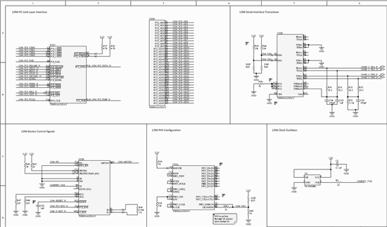

I've got a design using a TSB83AA23. I've noted the other conversations with regards to achieving sync between two 1394b nodes (attempting a 400b interface here).
I can confirm that the TPA and TPB are toning but not achieving sync. I suspect that BMODE and CPS are incorrectly connected. I've attached the schematics. Can someone comment on those connections and see if they can spot any others I should consider.

    The schematic has an "x" on some connections including BMODE, if this is only editorial then BMODE is connected to Vcc and that is correct.
    CPS should be connected to the power coming from the cable (bus power), is CNA high?

    The "x" exist only to tell the software tool (Altium) to ignore a rule violation (I/O connected to power).
    CPS is hardwired to ground...in this application we don't have cable power...what happens if CPS is low (ie. do I need to change this).
    CNA is not connected and not accessible.

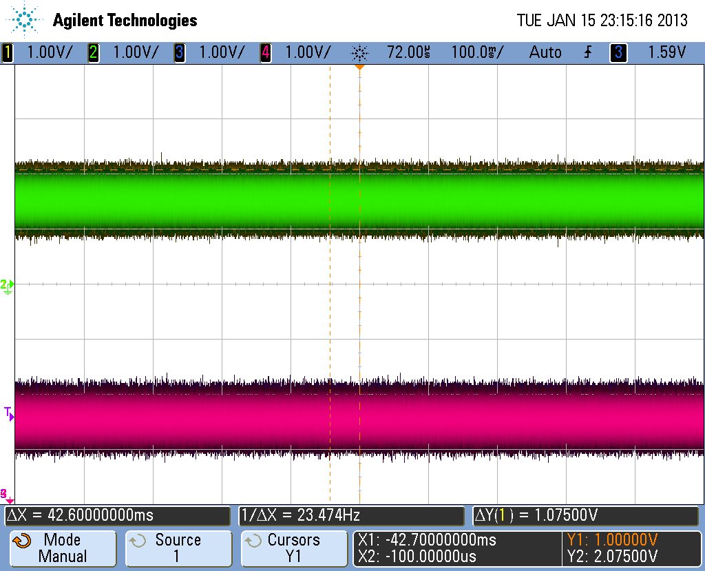

  • Here are some attached scope capture.
    The first image is with the firewire cable unconnected. The bottom traces are of TSB.

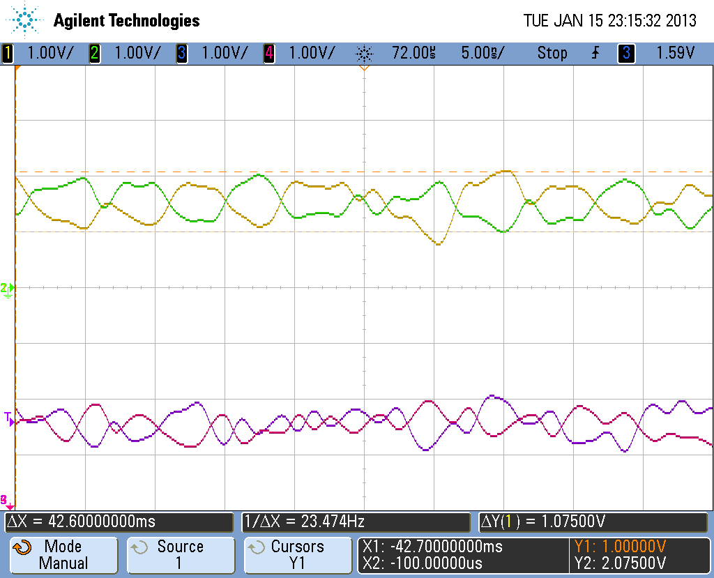

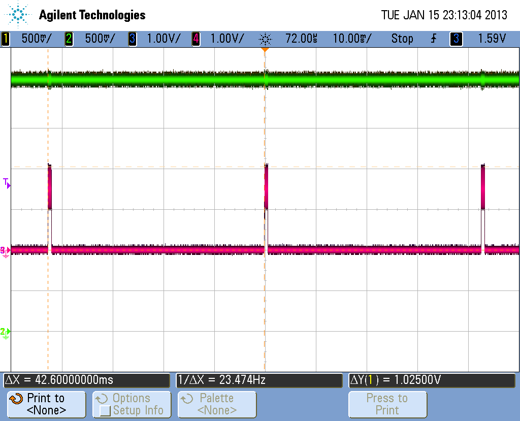

    Here is what the signal looks like if I connect the cable to a unibrain firewire pci card (same chip). I'm assuming that this is showing a link but could be wrong. The pci card is not installed in a machine but is powered on the benchtop.  The following image is fine detail of the same traces (I'm limited with a 500MHz scope probe).

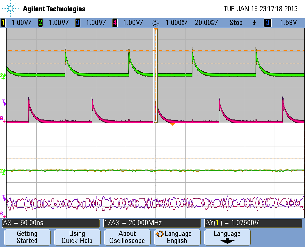

    This last image is what generally occurs when I connect my board to a firewire connected PC (a PCIe adapter card) and sometimes to my unibrain card. The linux system is not reporting detection of an additional node as it does if I connect the PC to the Unibrain card (as a reference). TSA and TSB appear to be talking or trying to establish a link. I'm not sure.
    Can you describe your set up? Are you using a 1349b cable? You said you don't have cable power but you also are saying "...cable unconnected..." If you have a 1394b cable, connect CPS to pin# 8

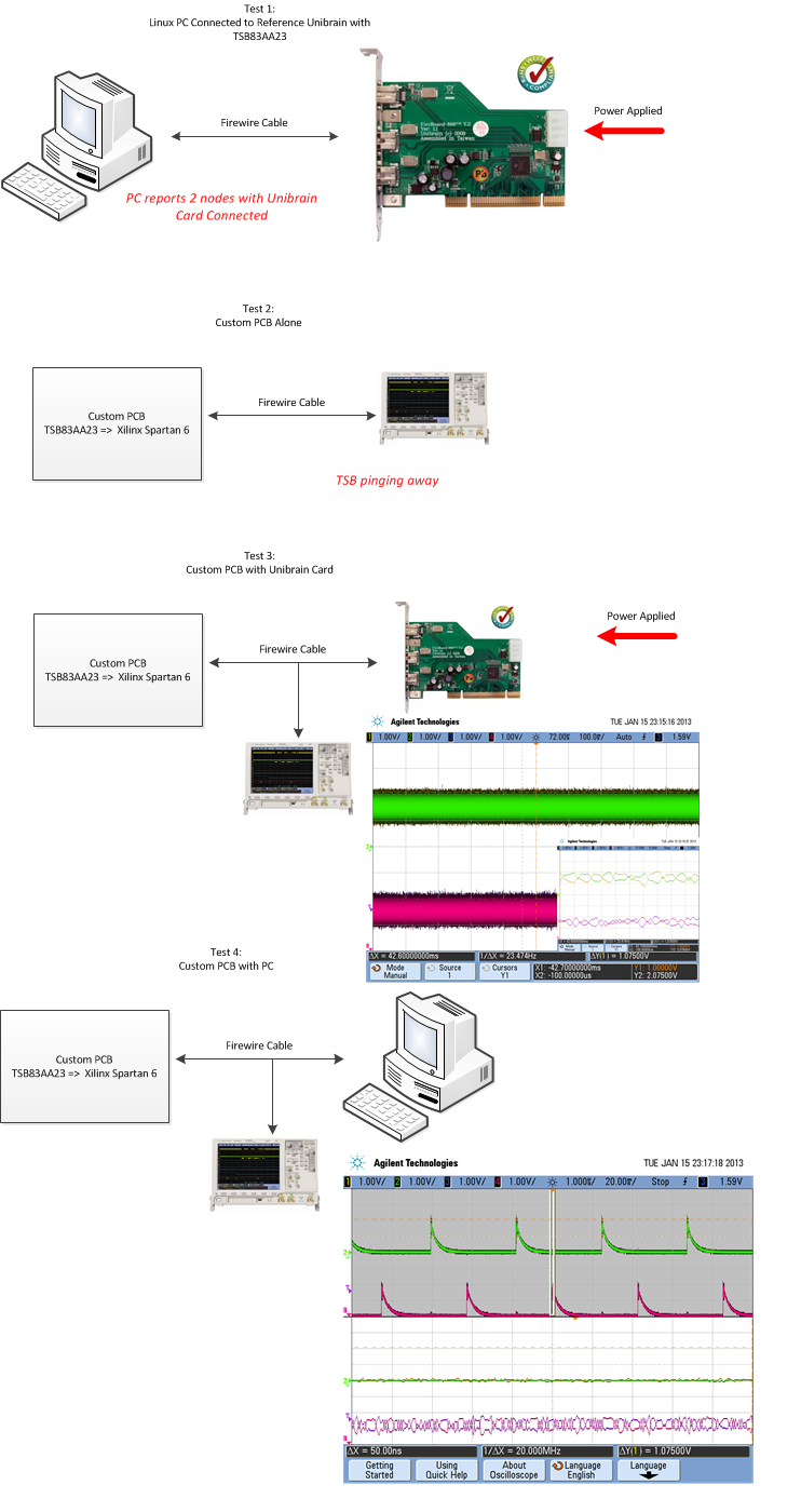

  • Here is a summary of my test setup in graphical form.
